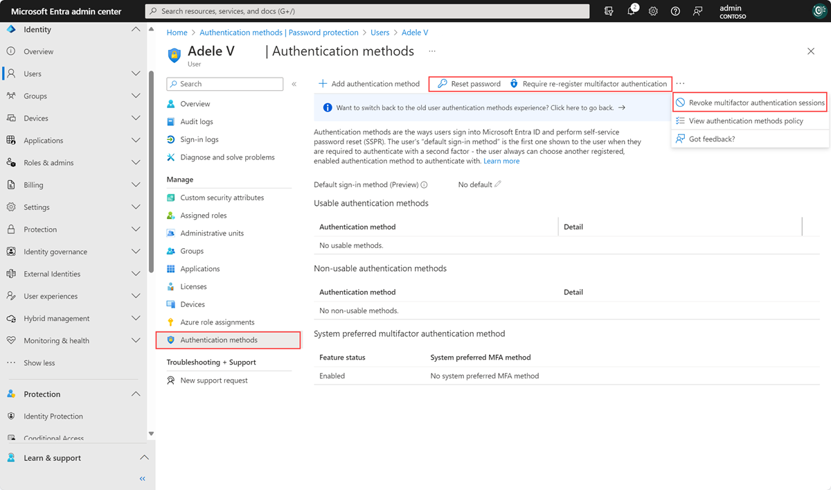

    If you are an administrator, please confirm whether another Global Administrator or Authentication Administrator can still access the tenant. If so, they can reset your MFA configuration by:
    • Signing in to the Microsoft Entra Admin Center
    • Navigating to Users > Your Account > Authentication methods
    • Selecting Require re‑register MFA
    You will then be prompted to set up MFA again at your next login.
