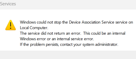

how to fix bluetooth disconnect and connect automatically when i do not hear anything i disabled allow the computer to turn off this device to savepower in power management and i restarted bluetooth support service and made it automatic

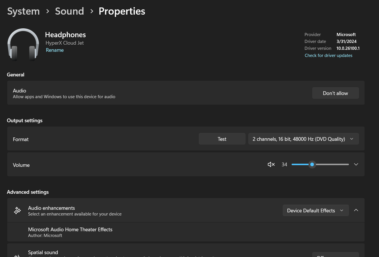

May I please know which audio output device is selected as the default in the System Sound settings?
Go to Start > Settings > System > Sounds > Choose your default audio output device.
Make sure your headphones are selected.
