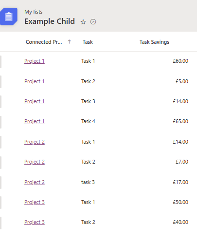

child list
Parent list
I am working on a project that involves multiple Microsoft Lists that will eventually feed through to a PowerBI Dashboard.
On my parent list I have a list of projects and on the child list I have a list of tasks, all the tasks will have a savings allocated to them. The child list also has a lookup field connecting to the main list. I am trying to use PowerAutomate to automatically calculate the sum of all the task savings in the child list and update the corresponding row in the parent list, however I am struggling to get the automation to work correctly.
