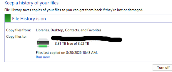

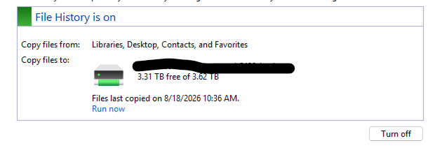

Win11 file history is no longer executing the scheduled file backups to my network connected external hard drive. The network drive is connected and working. Files can be manually saved to the external drive, but the File History is not backing up to the disk. I could use some troubleshooting tips to find out the problem. The files to be backed up are all in Libraries, which is what File History seems to have set as the default for what is to be backed up. Backup is Turned On and scheduled for Daily.

    Fixed with the Optional update released on 22nd September.
    https://yourwindowsguide.com/2026/09/file-history-not-working-after-september-update.html
    https://support.microsoft.com/en-us/servicing/os/windows-11/2026/09/kb5124010-windows-11-24h2-25h2-update
    [File History] This update addresses an issue where File History might fail to back up or restore files to an external drive or network location. Affected devices might incorrectly display a “Reconnect your drive” message even when a compatible backup drive is connected and working properly.

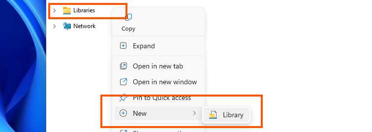

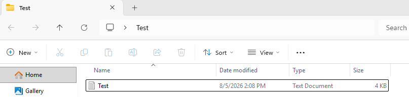

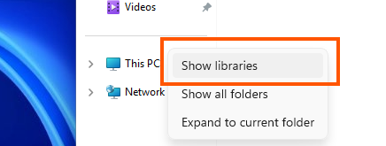

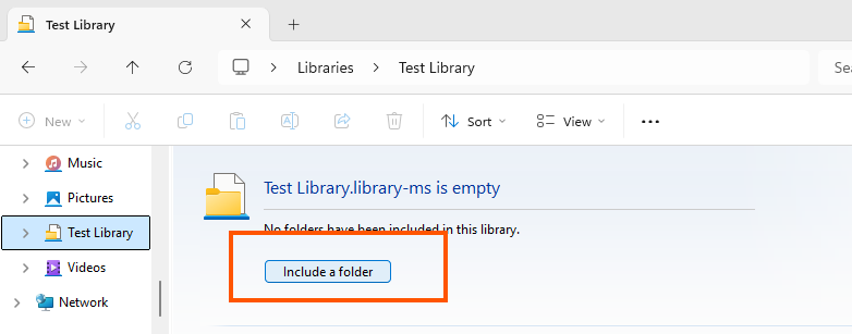

    The fact that File History cannot successfully back up to either the Buffalo device or a USB flash drive suggests that something within the source data being scanned on PC1 may be preventing File History from completing normally. This might be a bit troublesome, but as a diagnostic step, could you try temporarily reducing the scope of what File History is backing up?
    • Uncheck / Remove the folders from backup source
    • Temporarily remove other custom folders (if any) from Libraries.
    • Run File History again and see whether a backup completes successfully.
    If a minimal library backs up successfully, we can gradually add folders back until the failure reappears. That may help identify whether a specific folder, reparse point, or file is causing File History to stop.
