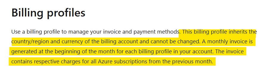

The root cause here is that billing currency is not a Cost Analysis display setting, it is a property of the billing account and billing profile that gets locked in at the time that billing account was created, based on the billing address and agreement type at signup. Cost Analysis lets you toggle the currency purely for how figures are displayed to you on screen, but this has no effect on what currency your actual invoice is generated and charged in. If your invoices changed from ZAR to USD starting end of June 2026, this almost always means the billing account itself changed, commonly because a Microsoft Customer Agreement (MCA) billing profile was created or migrated to replace a prior agreement type (such as an expiring Enterprise Agreement or a CSP relationship), and the new billing profile was provisioned with USD instead of ZAR.

  1. Currency cannot be edited on an existing billing profile
There is no portal control to change currency on a billing profile once it is created, this is by design since currency is fixed at billing profile creation time based on the legal address entered. Editing the address afterward does not retroactively change the currency of an already provisioned profile.

    The Cost Analysis currency toggle is display-only it just changes how figures appear on screen and has no effect on the currency your invoice is actually issued in. The invoice currency is a fixed property of your billing profile.
    So the currency is locked in when the billing profile is created, based on the sold-to address and agreement type at that point.

    Since the currency on an existing billing profile cannot be edited in the portal, the only supported path is to have your subscriptions billed under a ZAR-configured billing profile/agreement. South Africa is a supported MCA country, so a ZAR MCA profile is possible when transacted through a Microsoft seller or CSP partner (not via direct Azure.com signup, which is USD-only).
