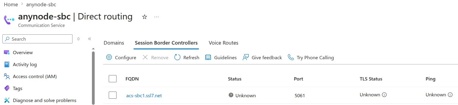

Session Border Controller (SBC) registered in Azure Communication Services (ACS) Direct Routing remains in "Unknown" status (Status / TLS Status / Ping all show Unknown) despite the SBC (anynode) successfully completing TCP and TLS handshakes with the ACS signaling hub. No SIP response is observed at the application layer, though raw packet captures show bidirectional data exchange and clean connection closure.
How can we investigate and troubleshoot this further ?

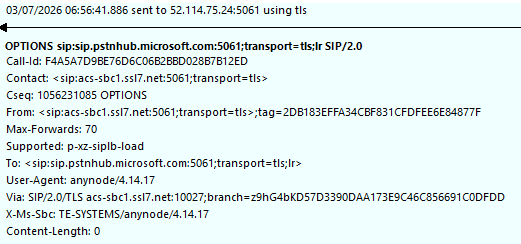

2026-07-03T07:14:56.9+00:00 Hi @Venkatesan S thank you for further clarification.
We did confirm that SBC FQDN as registered in ACS:
matches exactly what is being sent by our anynode SBC in SIP OPTIONS headers:
OPTIONS packet as above is sent continuously approximately every 15 seconds over established TLS connection to all three Microsoft sip hub addresses. The requests are not replied to over SIP and TCP connection is immediately closed.
Unfortunately removing and adding back SBC on the ACS side did not resolve the problem.
