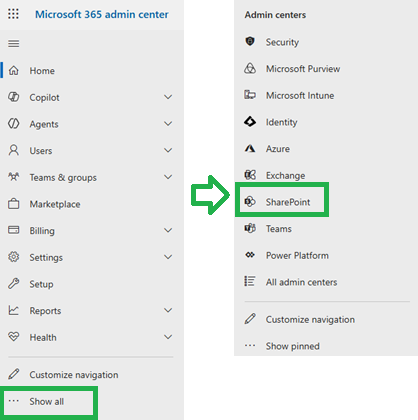

    Files saved on a local file server or network share do not automatically appear in SharePoint Online. SharePoint doesn't pull content from servers by itself. Files will only appear in SharePoint when they are:
    • Uploaded manually.
    • Synchronized using the OneDrive sync app.
    • Migrated using a supported tool such as Migration Manager or the SharePoint Migration Tool in SharePoint admin center (Microsoft 365 admin center > Show all > SharePoint).

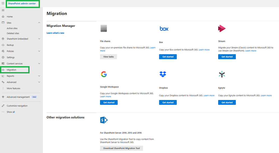

    Scenario 1: Files are only stored on the server or network share
    If the files were never uploaded or synced to SharePoint, then this behavior is expected. You may consider migrating files to SharePoint:
    Note: This step requires action by your organization's IT administrator. In case you do not know who is your IT admin, kindly refer to this article: How do I find my Microsoft 365 admin? - Microsoft Support
    Go to the SharePoint Admin Center and open the Migration.
    Set up a Migration Manager agent on a machine that has access to your file server.
    Create a migration task by setting:
    • Source: your file server path.
    • Destination: the SharePoint site or library.
    Run the migration and review the report to check for skipped or failed files.

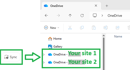

    Scenario 2: Files are already in SharePoint but not visible on your device
    If the files exist in SharePoint but don't appear in File Explorer or locally, the issue is likely related to sync configuration.
    Please follow the steps below to check and repair the sync:
    Open the SharePoint site in a browser and confirm whether the files are visible in the document library.
    Click the Sync button, or use Add shortcut to OneDrive if available.
    Check that the OneDrive app is running on your device and that you are signed in.
