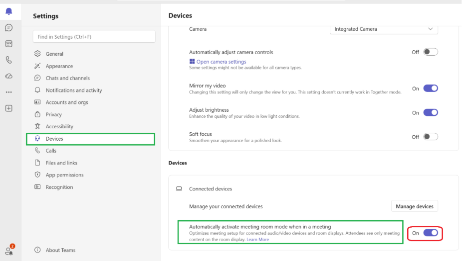

There’s a good chance this isn’t an issue with the Logitech MeetUp itself, but rather how the Teams desktop app is recognizing your setup. From what you described earlier, Teams is likely detecting you as being connected to a meeting room or room device. When that happens, it can switch the experience to a “room mode,” where the video gallery is optimized for the room display instead of your personal screen. That’s why the camera or gallery might not appear the same way as it does in the web version, or seems to be hidden on your laptop.
You can try adjusting this behavior directly in Teams. In the desktop app, go to Settings and more, then Settings, then Devices, and turn off the option called “Automatically activate meeting room mode when in a meeting.”
This setting can cause Teams to automatically switch modes when it detects connected room audio or video devices like your MeetUp. After turning it off, please restart Teams, join the meeting again, and manually select the Logitech MeetUp camera if needed.
Please give it a try and feel free to let me know how it goes, I’m here to help if anything still feels off.
