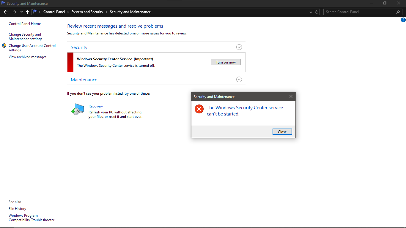

Hello everyone, i have downloaded a game from oceanofgames, and wrongly turned off windows Security and it can't be started anymore and defender is no longer working, i uploaded an image with the notification that appears when i open my laptop, by the way my windows is 10, also i'm not good at that laptop fixing things, hope you can help me with easy ways to follow and apply
hope to hear from you guys soon
thanks in advance.Screenshot 2026-05-28 152821

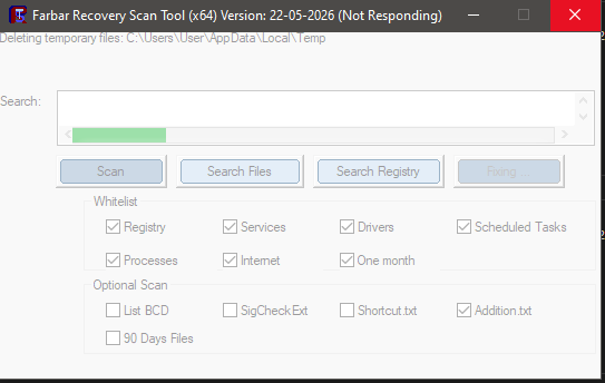

The fixlist will remove the malware and run the System File Checker. You will then need to perform a repair installation to restore Windows Defender and its services.
  • Save Fixlist.txt to your Downloads folder.
  • Close any apps with unsaved work.
  • Run FRST64.exe and click "Fix".
  • The computer will reboot to complete the procedure.
Please upload Fixlog.txt
For the repair, go to: https://www.microsoft.com/en-au/software-download/windows10
  • Just below Create Windows 10 installation media click on Download tool now
  • Run MediaCreationTool22H2.exe, accept the license terms then select Create installation media.
  • Use the recommended options then for Choose which media to use, select ISO file.
  • Once downloaded, right click the ISO and select mount, then launch setup.exe
  • Click on Change how Setup downloads updates and select the option Not right now.
** If the option to Keep personal files and apps is greyed out, abort the installationenter image description here

You will have active malware running as a result. Please provide Farbar Recovery Scan Tool (FRST) logs for analysis.
https://www.bleepingcomputer.com/download/farbar-recovery-scan-tool/
Note: If you are using Edge or Chrome, SmartScreen may initially block the download. Click on the three dots next to the warning and select Keep => Click the Delete drop arrow => Keep anyway.
  • If your computer's language is not English, rename FRST64.exe to FRST64English.exe
  • Run the tool, leave the default settings, and press Scan.
  • Zip the logs, FRST.txt and Addition.txt, then upload to a cloud storage service like OneDrive, Google Drive or gofile.io
  • Post the share link.
https://support.microsoft.com/en-us/office/share-onedrive-files-and-folders-9fcc2f7d-de0c-4cec-93b0-a82024800c07
