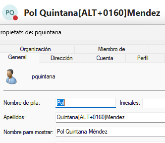

    I found a solution by using ALT+0160 to seperate double surname.
    "Max Muster[ALT+0160]Mann" instead of "Max Muster Mann"
    see: https://maxdorf.com/article/ascii-characters
