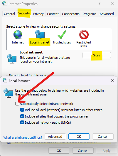

Here is a simple solution that worked for me -
in the file explorer, just disable this check box as shown in the image, this simply worked for me
(This happened on windows 10 as well!)

Unfortunately, this doesn't work for me. I think it has to with the files being on a network drive.
I have tried both provided solutions.

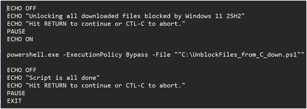

or also elevated ps, just recursively unblock a certain parent folder's pdf files (BUT, you'll have to redo that command with e.g. new downloads; but also note, you can just right click on any given file > properties, and at the bottom of the General tab, is the new security option, where you just check that "unblock" box):
gci c:\users\youHere\downloads -include *.pdf -recurse | unblock-file

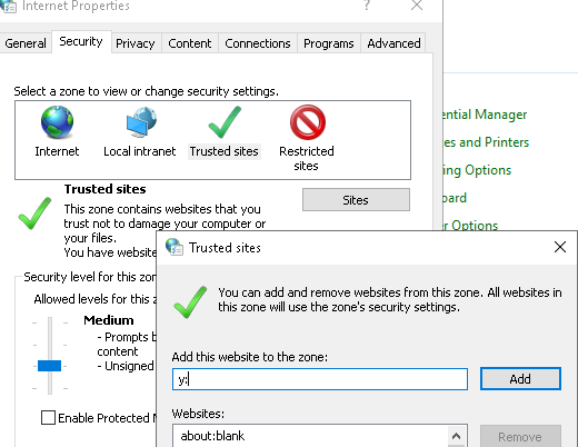

Adding IPs to Internet Options - Trusted sites only works for files created by the same machine. Files received from others or downloaded from Internet are still getting blocked in the preview panel
Adding the network location to the trusted locations as file:///Z:/... worked for me (you have to disable https requirement)

If you add the file location to the trusted sites tab in internet options, this fixes the issue. Use file://[file location]
This can also be added as a group policy to apply to all the PCs across a domain.

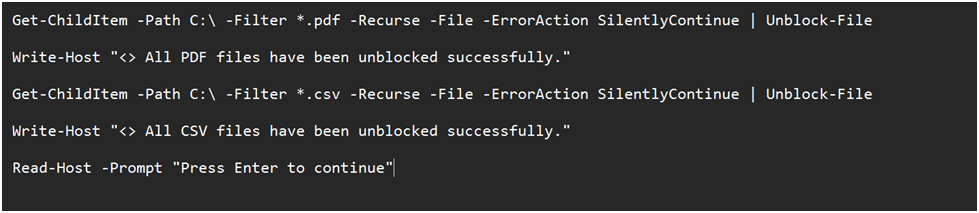

I ran the command Unblock-File -Path "C:\Users\admin\Documents\*.pdf" in PowerShell, and it only temporarily resolved the issue. When the user saves new PDF files, the problem comes back again.
I tried this, but unless I missed something else, it turned off all of my previews, even the ones that I had "fixed" using the "unblock" trick that I described in a previous post.

I also tried this - but it turned off ALL previewing of files (both local and on a network).
@Jeff N your suggestion worked for my system - none of the other suggestions (and I've been following this since Oct 16th) have worked for me.

$folders = @(
"$env:USERPROFILE\Downloads",
"$env:USERPROFILE\Documents",
"$env:USERPROFILE\Desktop"
foreach ($folder in $folders) {
if (Test-Path $folder) {
Write-Host "Unblocking files in $folder..."
Get-ChildItem -Path $folder -Recurse -ErrorAction SilentlyContinue | Unblock-File
Write-Host "✅ All files have been unblocked successfully."
🔹 Save it as UnblockFiles.ps1, then run it once as Administrator (right-click → Run with PowerShell). This clears MOTW tags from typical folders where downloaded content lives.
I hope it will help everyone until Microsoft has a fix for it. The above may not be a proper solution, and may not work for everyone. But is a workaround for now and worked for me.

guys use this method also for domain users and if you using files over netword drives
just add the path of Ip address of the netwrok drive where it says the website as described below and it will work
ust add the path where your files are saved.
Thanks Hisham, this worked for me! I had the Sharepoint already in my trusted sites with no joy, but today when I put in the specific path for where I keep my Xero invoice downloads, and tested a file saved into a subfolder of that, it worked!

if there is share folder then open control panel then internet option, security and trusted sites and add your server ip address, then you can view the pdf file in folder (File explorer preview).
but if this is your personal computer then you need to open pdf file and save again on same location in your computer then you can preview in folder or go to file explorer options and open view and make sure option checked

Control Panel-> Intrnet Options->Security Tab
Trusted Sites->Sites
Add your network drive Z: (or something), uncheck Require https.... box
Still the same cannot view for the network access. Thanks

(1) I am going to share my solution to this problem in this post, and just know that I'm using a non-networked laptop at home, but first
(2) THANK YOU to everyone who shared so many varied solutions.
(3) I also want to point out that this is NOT ONLY HAPPENING TO PDF FILES because I have had the exact SAME PROBLEM with downloaded CSV FILES as well.
(4) MY SOLUTION PART 1: I constructed the following .ps1 file and saved it at C:\ which is the root of my one and only laptop drive. It is named "UnblockFiles_from_C_down.ps1".
(5) MY SOLUTION PART 2: Whenever needed, I launch the following .bat file from my desktop. It is named "UNLOCK ALL DOWNLOADED FILES.bat".
(6) I'll just add that I like the interactive pieces, like the ECHO and PAUSE commands because it helps me see that the fix is running and not getting stuck or crashing. I didn't want to unlock every darn file on my drive, but having discovered that my CSV files are also locked, I have the .ps1 script set up to do 2 different types of files, and there is the template for adding additional loops if and when more file types get bungled up in this dreadful new "feature".
I still do not understand why doing a preview is so dangerous, but blatantly opening the whole file in an app is somehow gloriously safe. What am I missing here?
Still working successfully for me. Just wanted to add a bit more.
I've increased the scans to include PDF, CSV, TXT, JPG, and PNG files. I'll add more file types as needed. I'm not inclined to do all files everywhere, nor do I want to play with writing a loop. I did also add a timer for the whole operation. Start to finish on a recently restarted laptop with 1T SSD drive, including my momentary pauses to hit a key: 2 minutes 45 secocnds (0:2:45).

Hi everyone - for network users like myself who weren't having any luck with some of the other suggestions in this thread - here's what worked for me:
Control Panel > Internet Options > Security Tab > Local Intranet > Sites > Click "Automatically detect intranet network". Then OK, then Apply, then OK. After I did this I could preview files again, including PDFs.
Kim Nance suggestion worked for me. Legend. ...
