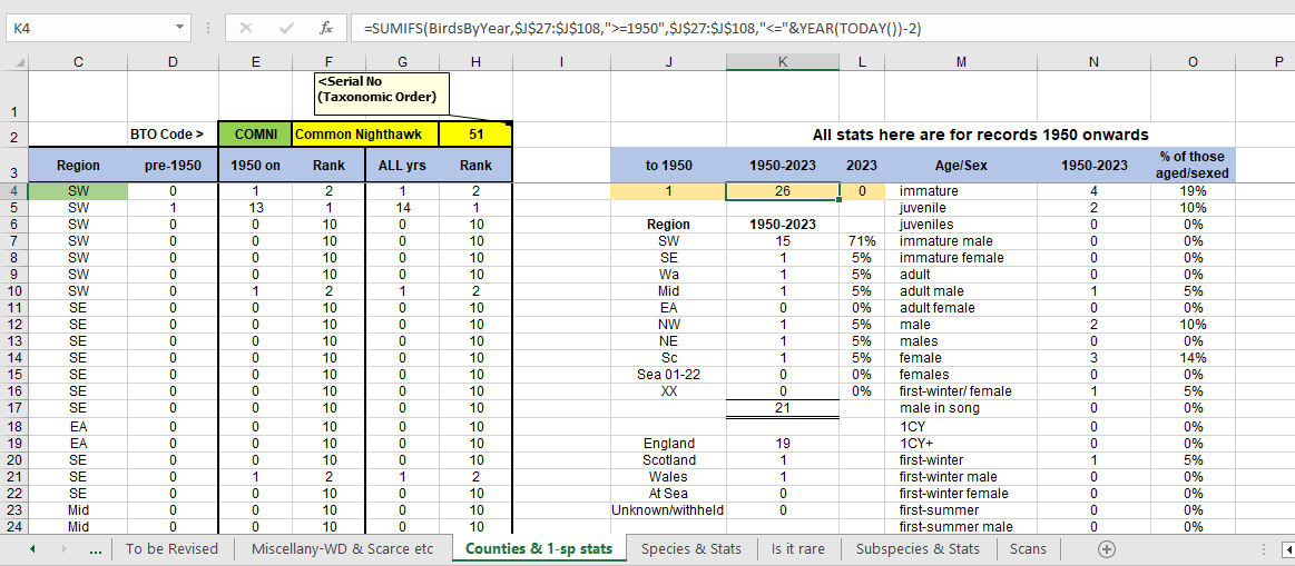

    2025-03-12T10:41:56+00:00
    ="1950-"&YEAR(TODAY())
    Can that be amended to read currently 1950-2023 please, then it adds the year in the new year.

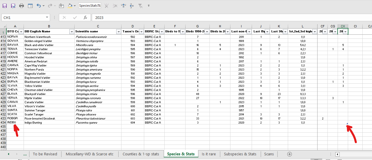

    1. As you did The Records sheet in pale blue alternate rows, would it be possible to use the Format Orange medium 7 to give alternate coloured rows. But their is a problem in that the dragging handle is in cell CH434 in the Species & Stats sheet and I can't get rid of it to start again. "> Hi Jeovany

    1. ="1950-"&YEAR(TODAY())
    Hi Keith
    1. Sorted: the formula has been corrected to
    =COUNTIFS(pre1950tb[BTO],Specific_Species,pre1950tb[Progress],"OK",pre1950tb[CountyCode],$A4,pre1950tb[Year],"<1950")
    1. Sorted: the formula has been corrected to ="1950-"&YEAR(TODAY())-2
    It means that in 2026 the formula will return 1950-2024,
    in 2027 will return 1950-2025,
    In 2028, it will return from 1950-2026, and so on.
    I also corrected other formulas to change calculations automatically each year
    1. That is correct, as it shows/marks the table boundaries, it will automatically move/expand when you enter new data
    What do you mean by "...I can't get rid of it to start again."?
