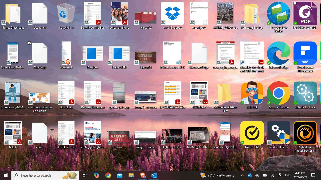

    Also, my OneDrive in my task bar has been "looking for changes" as you can see in the below for over a week now - how long does the syncing take? I've kept my pc on the entire time. Thanks again Craig, Paulina
    Definitely, something is not working correctly.
    Try this: Fix OneDrive sync problems
