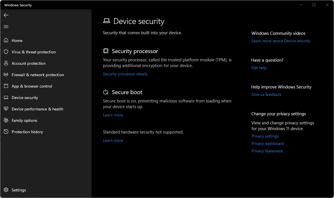

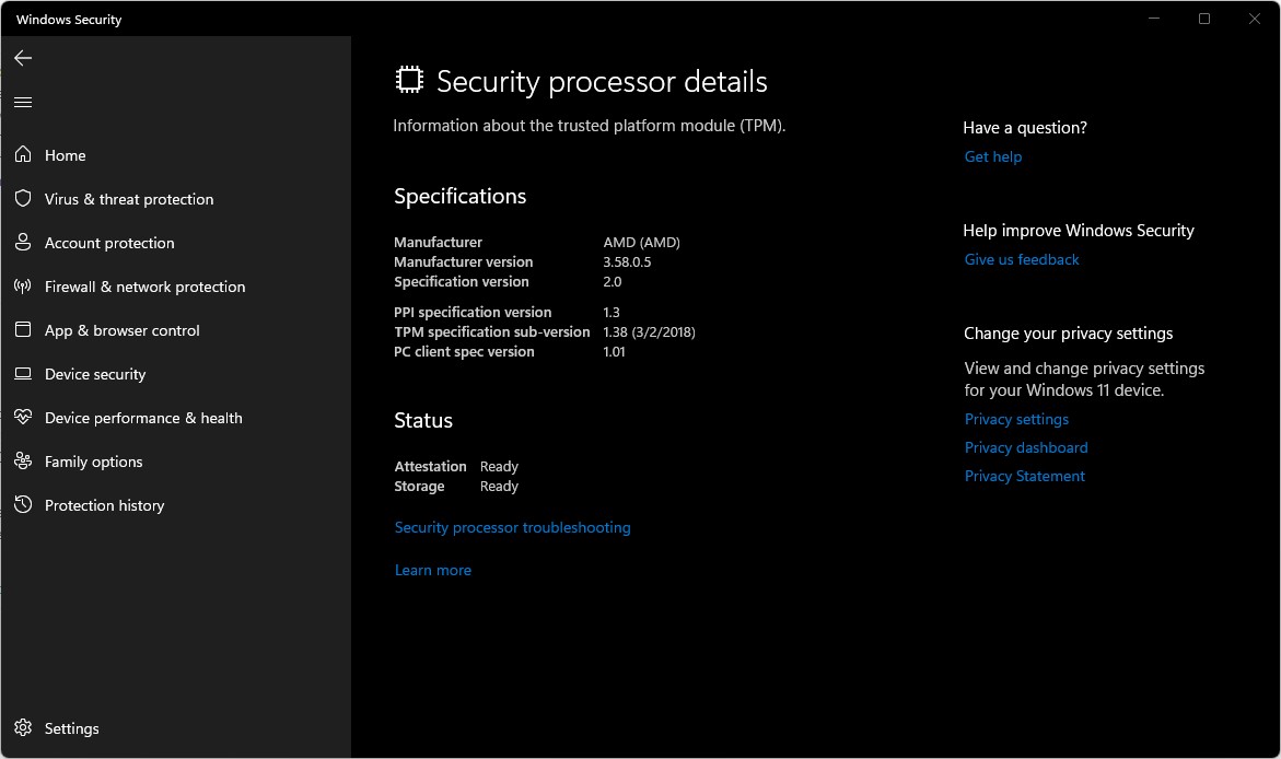

    I did exactly what you described.
    1. I verified my ASUS BIOS that UEFI is set and CSM is off. Also I cleared the keys and verified that the TPM of the processor is set and not descret. (AMD 5800x)
    2. I verified the steps you explained and ran the wizard to be really sure. This caused a reboot and enforced that I verify myself during login with authenticator etc.. See the attachments. I also checked if the device manager shows the TPM 2.0 Module.
    3. So all looks good but I still get those error messages.
    Either AMD is not able and something is wrong on my CPU die or I really consider to throw Windows 11 out of the window to be honest. Microsoft needs to talk with hardware manufactures and agree on a simple process but this is a pain. I am a professional on IT and even I fail.... what is MS thinking of users like non professionals, not understanding of how keys do work? Do not except that people read manuals about security standards... they will return the devices simple as it is and buy an apple product.
