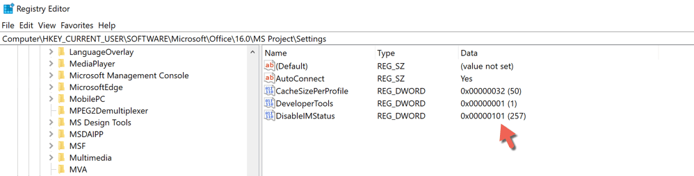

    Same problem I had this morning when I tried to run a macro from my Global. I asked my MVP colleague Dale Howard about it and he said he doesn't have an issue with Project with Office 365 so I suspect those of us who have the standalone desktop version are the affected users.
    How exactly did you implement the registry fix? Perhaps I did it incorrectly but this is how I tweaked it.
    And just for kicks, I also added my Project Global as a Trusted location. That made no difference.
