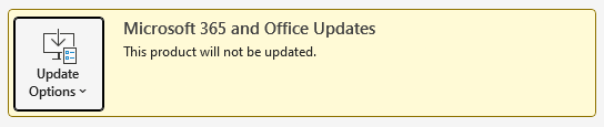

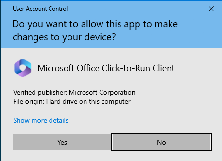

    2024-07-19T22:24:25+00:00
    Hi Paul,
    I wrote the article on AccessForever.org and Karl has asked me to chime in.
    First of all, when you disable updates, you do that to avoid the buggy version to be installed immediately again.
    Once you select the "Disable Updates" button you'll be prompted with "Do you want to allow this app to make changes to your device?"
    and you have to answer with "Yes". Then you'll see the update button with yellow background and the text "This product will not be updated".
    If you don't have this experience, the situation needs to be fixed first, such as: do you have elevated rights on your computer? Possibly some IT support needs to provide these rights for you.
    Once this hurdle is taken you can continue with the procedure laid out in AccessForever.org.
