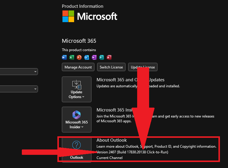

    As I noted in my 09-Aug-2024 post <here> on page 8 of Prius 04's topic, there have been multiple security vulnerabilities patched in MS Office click-to-run (C2R) since Version 2405 / Build 17628.20164 was released on 19-Jun-2024 (see the CVE list at Release Notes for Microsoft Office Security Updates) so turning off automatic updates and rolling back to an older, unpatched version does not sound like a wise suggestion.
    If you are on the "regular" Current Channel of any MS Office C2R product (e.g., Microsoft 365 C2R, Microsoft Office 2016 / 2019 / 2021 C2R) I think it would be much safer to copy and paste the command below into an elevated command prompt with Administrator rights to update to the latest Version 2407 / Build 17830.20138 released on 01-Aug-2024 to patch those known vulnerabilities:
    "C:\Program Files\Common Files\microsoft shared\ClickToRun\officec2rclient.exe" /update user updatetoversion=16.0.17830.20138
    Before you roll back to Build 17628.20164 I'd suggest you contact M365 Tech Expert Max and ask them to clarify if there's a specific reason why they are not suggesting an update to the latest available version as a temporary workaround. Once Microsoft has a bug fix for this 30088-27 update error I can't imagine any circumstance where they would not be able to push the fix out to affected users like me who are keeping their MS Office C2R installation up-to-date using this command prompt method.
