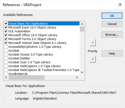

    1.- I don't have missing References
    2.- I don't have Syntax errors
    3.- I have discovered 2 more statements that were protected with "On Error Resume Next" and change the code to avoid causing "protected" errors. The "On Error Resume Next" was removed from those 2 statements.
    So far, executing my VBA code in Safe mode has allowed me to stay away from Excel crashing.
    Regarding the references I have, I am a little bit confused about how to check the versions of each of them.
    The references I have are the following:
    In the case of the first reference:
    a) The above window does not show the complete path of the location of the reference.
    b) I searched for "VBA7" on my Program Files folder and found that I hace 2 VBA7.1 folders; one for x86 (32bit) and another for x64 (64bit).

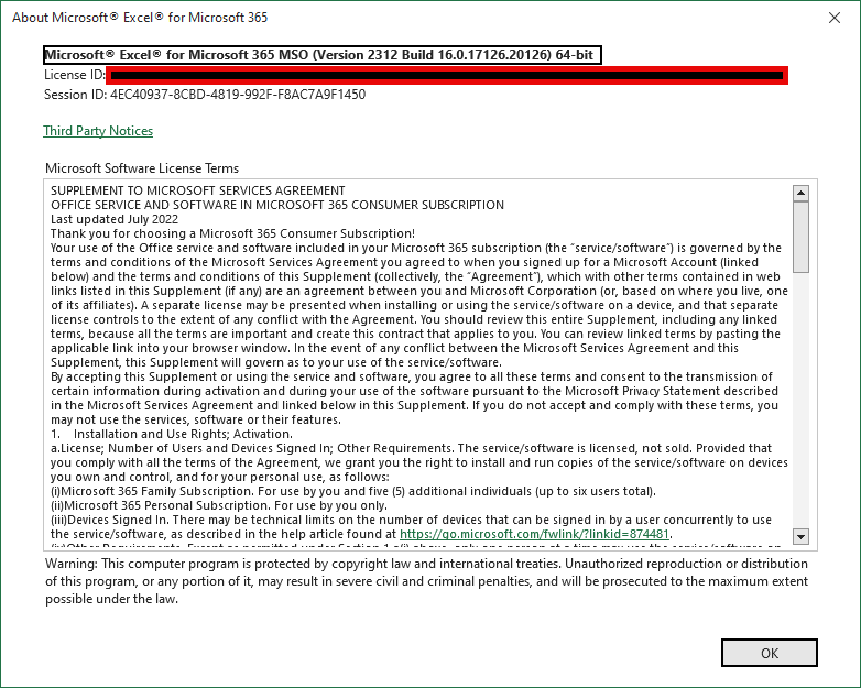

    c) My Microsoft 365 is
    64Bit as you can see about and I don't know how to check which VBA7 is being used. I am assuming it is the 64Bit one since Microsoft 365 is 64Bit.

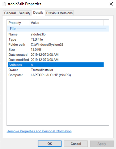

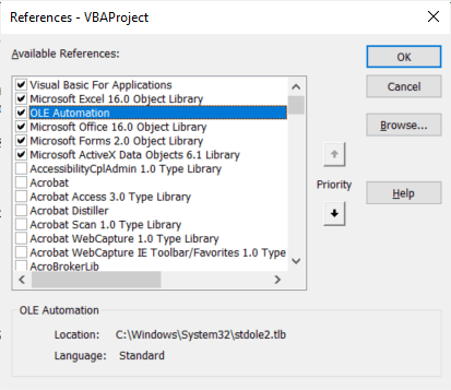

    There are other references like Ole Automation,
    That, as you can see, the Location points to file stdole2.tlb that I found and there is no version informatio about it as you can see below....
    In summary I don't know how to precisely check the versions of my References.
    Could you please point me to or let me know how to do it ?
    My Microsoft 365 is updated to the latest version.
