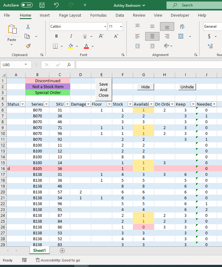

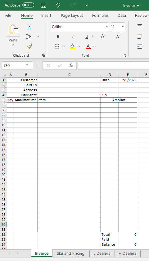

    2023-02-09T17:01:21+00:00
    Thank you,
    This is along the right path of what I am looking for, but not exactly. I guess I should have been a little more exact on what I was trying to do. I have created an invoice file to pull pricing off of my sku list and I am not trying to set it up do deduct the items from my inventory when I complete the invoice. Below are screen shots of my invoice and inventory pages.
    The important fields for the invoice page are the A column and the C column. I will need to search the inventory file (which I am probably going to have to adjust) for the match to Cell C6 in column B of the the Ashley Bedroom File (I am going to have to combine columns B and C probably) then I need to subtract Cell "A6" in the "Invoice" File from column F of the row that was found above. Then if the next row on the invoice has something in it I need to repeat until the next row is empty. I am not sure if this is even possible, but I have made some progress on it. Right now I am having alot of trouble finding the matching fields. I am using the test sheets screenshotted at the bottom and are very simple and still can't make if work.
