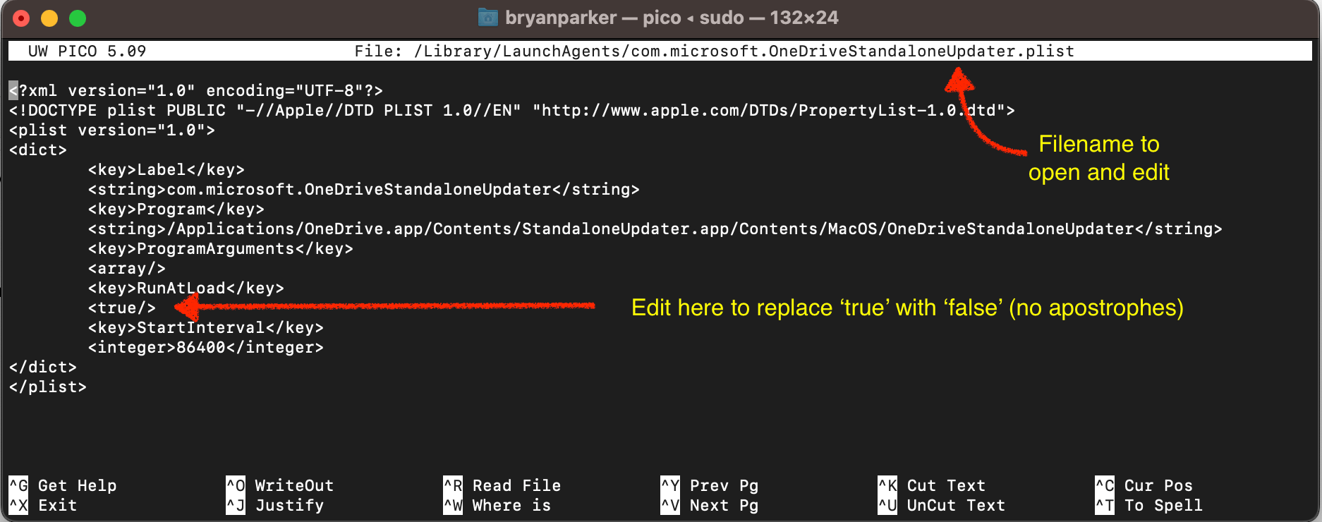

    4. Using the Mac Terminal to edit the plist to prevent auto-run of StandaloneUpdater works, but only in preventing auto-run during startup; alas, something else launches StandaloneUpdater when not in the context of a startup (which results in OneDrive being updated anyway); in short, this solution does not work long term

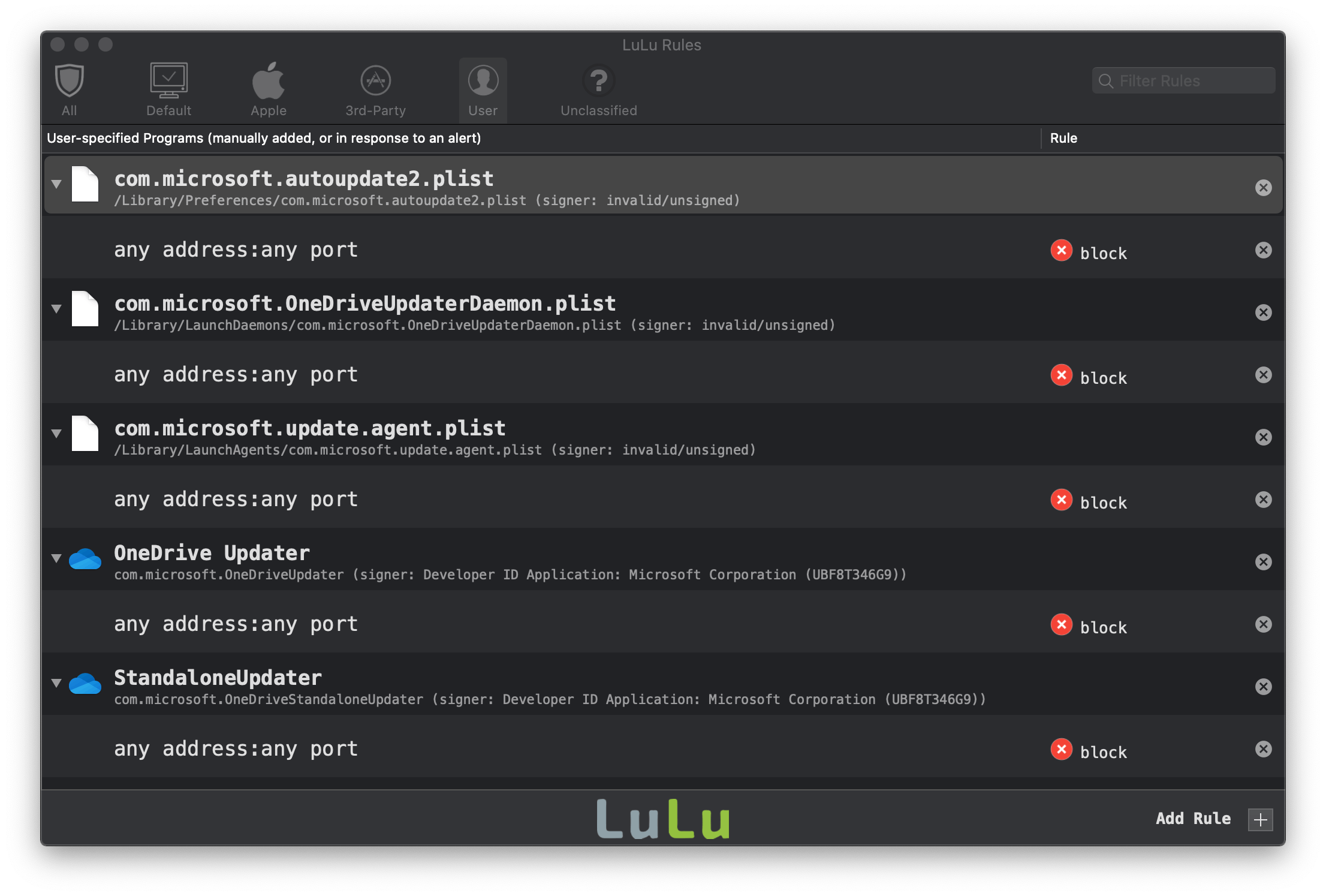

Option 2: Download & Install 3rd Party Firewall
  1. I use Lulu from Objective C, others report success with Little Snitch. Both appear to be free.
  2. For Lulu, download from here: Objective-See: LuLu. For Little Snitch, here: Little Snitch (obdev.at)
    • You should download and install Lulu or Little Snitch before you install OneDrive.
    • And then install OneDrive (with Wifi off).
    • Before launching the new OneDrive installation, continue with the steps (e.g. below) to block StandaloneUpdater. Best to do this before turning wifi back on and/or running OneDrive for the first time after the OneDrive install (because as soon as OneDrive launches, the StandaloneUpdater will instantly try to force an update—so this Lulu or Little Snitch shield has to be up and running before OneDrive gets to run)
  3. Assuming Lulu, after installation, go to Mac System Preference > Security & Privacy to give Lulu the necessary permissions
  4. Within Lulu, "Add Rule" and select StandaloneUpdater to block it. I also block OneDriveUpdater. (e.g. see 1st Lulu screenshot below)
  5. You can allow Apple apps and other 3rd party apps to run/connect, just not StandaloneUpdater (e.g. see 2nd Lulu screenshot below), so Lulu bothers you less with permission requests
