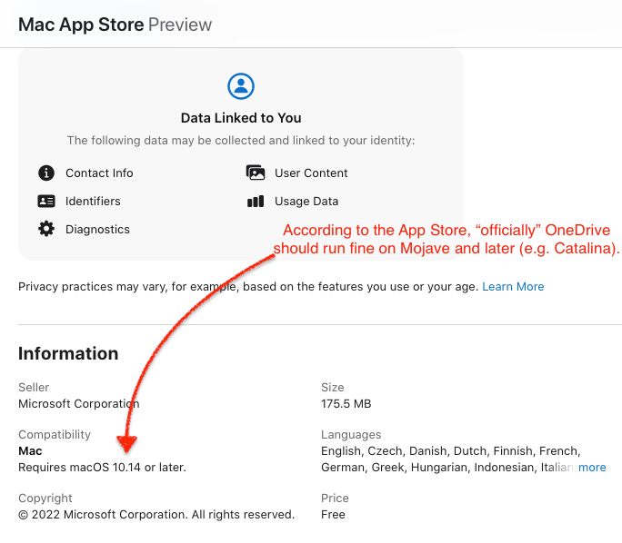

As of the time of this update, DO NOT install OneDrive from the App Store, it still has the older non-working version (23.076). That is because the working versions (23.081 and later) are still "insider preview" versions.

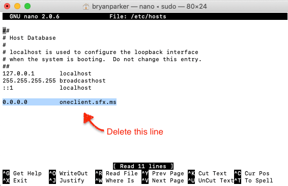

Editing the HOSTS File
  1. Launch the Terminal app (navigate to Finder > Applications > Utilities > Terminal, double-click Terminal to launch it.)
  2. Type (or copy-paste) the following command and press Return to run the "Nano Editor" and open the HOSTS file: sudo nano /etc/hosts
  3. Enter your computer password when asked.
  4. Using the down- and left/right arrow keys, move cursor down and and in front of this entry: 0.0.0.0 oneclient.sfx.ms
  5. Use the "delete" key to erase that entry (erase 0.0.0.0 oneclient.sfx.ms)
  6. Press Control-X to exit, press Y to save the changes when prompted, press enter key to select the default file name (which should remain unchanged)
After editing the hosts file to remove the reference to 0.0.0.0, you can click on the first link above to download the new OneDrive version.

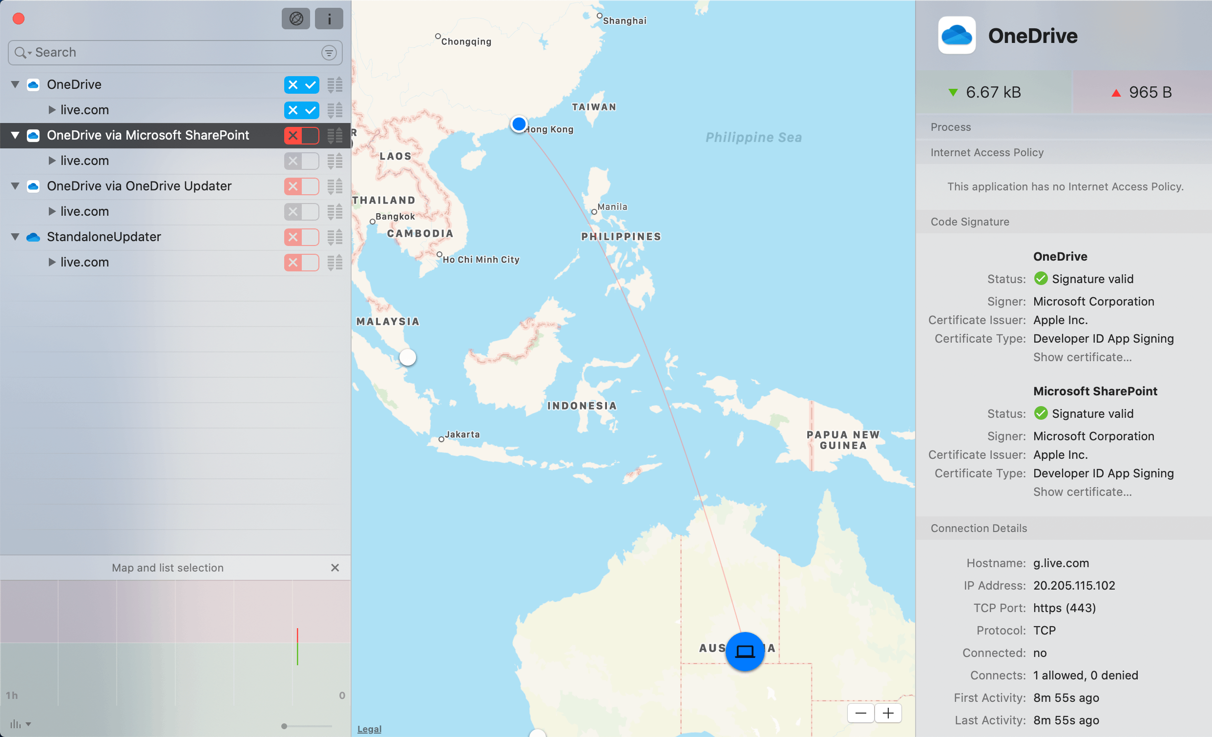

3rd Party Firewall
If you installed and enabled a 3rd party firewall (as I did), you can simply do any of the following: disable, quit, or uninstall.
In my case, I had installed Lulu. I disabled it first. I then downloaded and installed OneDrive version 23.081. Once I confirmed 23.081 was working, I uninstalled Lulu. (The new OneDrive version works with Lulu installed and disabled.)
In my experience, there was no need to first uninstall my current OneDrive version. I simply installed version 23.081 over version 23.002 (after I first corrected the hosts file and disabled my 3rd party firewall).

    Option 1: Editing the HOSTS File
    3. Enter your password when asked.
    4. Scroll ahead or down and press the Return key to create some space below the existing records.
    5. Enter (or copy-paste) the following non-routable network address: 0.0.0.0 oneclient.sfx.ms
    6. Exit the "Nano Editor" (Ctrl-X) and select "YES" to save when prompted (just press Enter to select the default file name already provided)
    7. Finally, type the following command to flush the DNS cache and press Enter: sudo killall -HUP mDNSResponder
    Option 2: Download & Install 3rd Party Firewall
    1. I use Lulu from Objective C, others report success with Little Snitch. Both appear to be free.
    2. For Lulu, download from here: Objective-See: LuLu. For Little Snitch, here: Little Snitch (obdev.at)
      • You should download and install Lulu or Little Snitch before you install OneDrive.
      • And then install OneDrive (with Wifi off).
      • Before launching the new OneDrive installation, continue with the steps (e.g. below) to block StandaloneUpdater. Best to do this before turning wifi back on and/or running OneDrive for the first time after the OneDrive install (because as soon as OneDrive launches, the StandaloneUpdater will instantly try to force an update—so this Lulu or Little Snitch shield has to be up and running before OneDrive gets to run)
    3. Assuming Lulu, after installation, go to Mac System Preference > Security & Privacy to give Lulu the necessary permissions
    4. Within Lulu, "Add Rule" and select StandaloneUpdater to block it. I also block OneDriveUpdater. (e.g. see 1st Lulu screenshot below)
    5. You can allow Apple apps and other 3rd party apps to run/connect, just not StandaloneUpdater (e.g. see 2nd Lulu screenshot below), so Lulu bothers you less with permission requests
    So, this is my current set up (as of 19 Apr 2023). I'll edit this post again if OneDrive still updates itself after this fix, otherwise, hopefully this post will remain unchanged after today. Hopefully this solution works for others too?

    So, according to the Mac App Store, Catalina (10.15.x) should still be supported (see screenshot below). But in practice, Microsoft has already moved on. Interesting thing is this: Microsoft OneDrive continues to work flawlessly on the older Windows 10 (released July 29, 2015), but is now unsupported on Catalina, which is a far more recent operating system (released October 7, 2019).
    In short, if you need OneDrive, we are better off being on a Windows system, since Microsoft has never (to my knowledge) "disabled" an app on Windows platform—all they do is just stop updating them. In fact apps on Windows XP still work (I have an old Windows XP laptop that works just fine). But on Apple devices, Microsoft (and other software vendors) will "kill" a program that has been running just fine until they decide to release an update that is not backward compatible anymore. Like what is happening now with OneDrive—the newer release is not compatible with Catalina, worse still, it isn't smart enough to keep the older version which is compatible with Catalina (like with Microsoft Office, which does not force an upgrade to an incompatible version, so I have a version of MS Office on Catalina that works just fine).
    What conclusions can I make? If I'm a dedicated Apple Mac user, I need to be prepared to buy new Apple laptop hardware in regular intervals (roughly every 3 years) in order to avoid falling behind Apple's OS upgrade life-cycle (which is aggressive!). My mid-2012 MacBook Pro feels positively ancient because software vendors are abandoning the last OS version it can run (which is Catalina).
