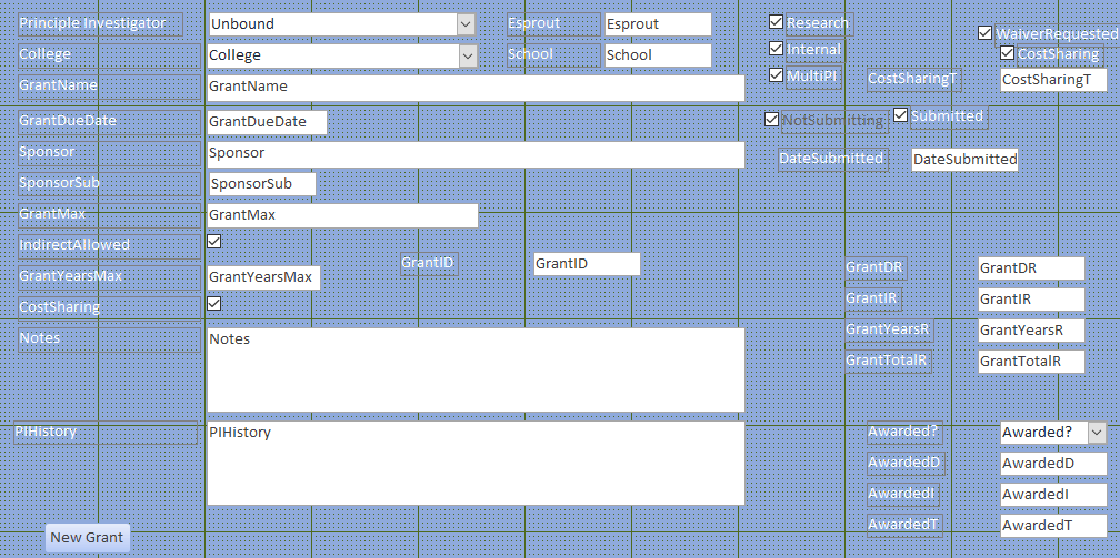

    2022-07-26T17:06:38+00:00
    So this is what the form currently looks like. At your advice, I did away w/ the other form. This is 100% functional EXCEPT for some weird reason when the form first loads, the PI is blank. I can tell from other fields that it's record 1... I'm not really sure why it isn't populating. It's not something that adversely affects anything, I just don't see why it's doing it. I'm too worried about breaking something to programmatically populate it with PI from record 1 - everything is working perfectly. I haven't started the multi-table version b/c I don't really understand the PK/FK or really why we're using multiple tables to begin w/ so I don't know where to start (other than making the tables which is simple). I'll make the form prettier and put our logo up there and some other stuff, but it works and I couldn't be happier lol. My boss, too.
