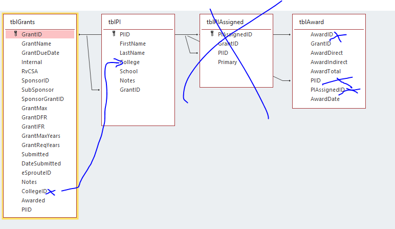

    Based on this, I changed some stuff around. Because all awards must be affiliated w/ a specific grant and we already have a field explicitly identifying grants, I'm going to make GrantID the primary key in tblAward.
    2022-08-01T16:17:11+00:00
    The term "research" is misleading; either a grant is for Research or it's not (ex: a grant for scholarships ) thus it's CSA. I changed the field to RvCSA and put validation in to force it to be one and to default to Research.
    Here's my current mess. I made some changes that may or may not make sense (based on my track record, they probably don't):
    Here are the changes I'm going to make after this email, by number in the pic:
    1. Things that are X'd out existed originally, but I plan on deleting them today.
    Here's what I think I actually want to happen:
    1. User wants to make a new grant. User clicks the new grant button. This brings up a New Grant form.
    2. A new record is created and automatically assigned a new GrantID
    3. The user enters pertinent information about everything but the researcher name (PI). This will be selected from a list.
      1. If the researcher isn't on the list, a button will pop up a form to enter the six fields in tblPIID that aren't autonumber.
        1. I'm struggling to remember how tblPIAssigned fits into this. Couldn't I just have a single field PIID on GrantID? I can't remember.
      2. Awarded = pending by default; awarded can be Pending, Awarded, or Declined
    4. We now have a new record with a unique GrantID that has everything it needs.
    5. At some point Awarded will be changed to "declined" or "awarded." If declined, the grant is basically done forever.
      1. If awarded, open awarded form, create new record, enter in GrantID
        1. It's possible to have 2 PIs from different colleges. To avoid double-reporting funding on reports, multiple records could be associated with the same GrantID. In this scenario, there is no PK for this field. Idk why that makes me nervous but it does. Maybe it's fine.
      2. User fills in the info. I need to be careful here; it's important that the user puts in the information specific to one PI if there are multiple PIs. My nightmare scenario is that there are two PIs, and the user puts the full amount for both. I need to think through this before going live w/ this.
    Actually looking at that I'm not sure what the point of tblPIAssigned is b/c I don't see where I'd need to use or reference it. It's probably b/c I don't understand how the relationships work. I think it's b/c I think like an amateur programmer instead of an amateur db guy, but I'm working on that. Anyway, feedback welcomed. I'm debating a table for sponsors for all of the reasons I made a table for PIs. The issue I see is that the users would be going into this and adding things A LOT and it may ultimately defeat the point of having it... but for now let's assume I'll make it.

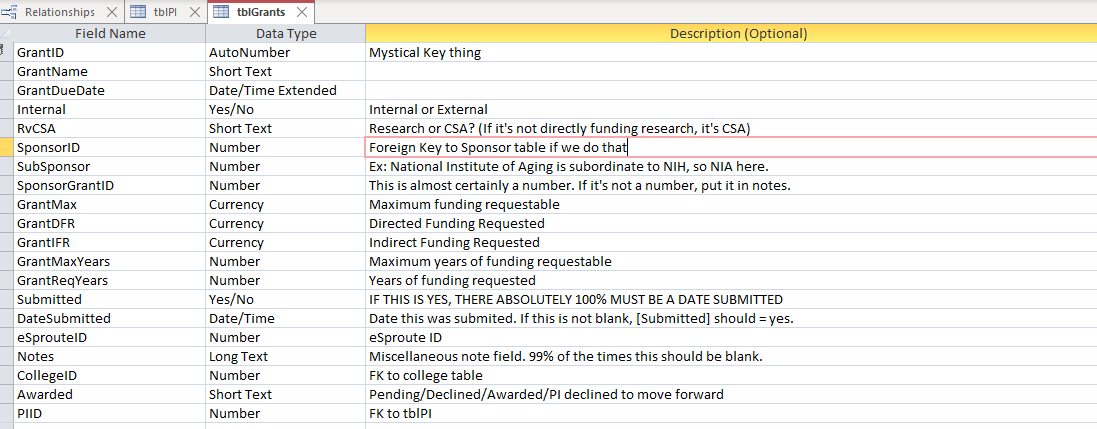

    Also for reference:
