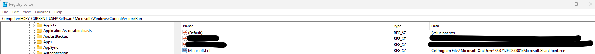

Remove on HKEY_CURRENT_USER\Software\Microsoft\Windows\CurrentVersion\Run the key Microsoft.Lists that points towards C:\Program Files\Microsoft OneDrive\23.071.0402.0001\Microsoft.SharePoint.exe
It's only been a couple of start ups, but this gets my vote as the simple solution, nothing else needed. I knew someone would come up with it, brilliant, thank you for fixing this annoying problem.
