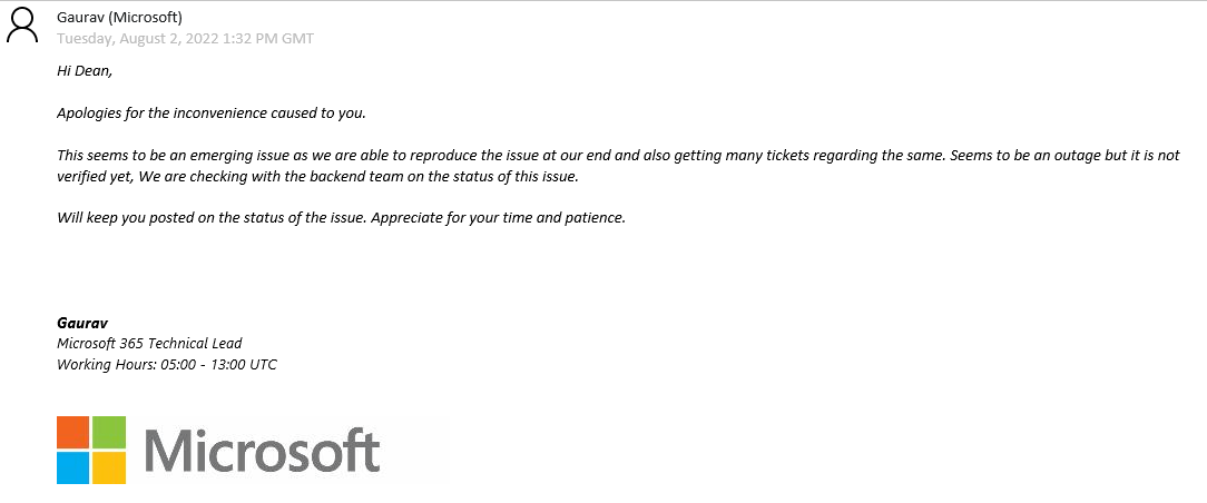

    Microsoft has advised its a known issue and they are working on it... looks like its a global problem.. just have to seat tight.,.

    2022-08-03T22:18:51+00:00
    Since the message on Monday or Tuesday stating that it should be fixed worldwide,
    I have been re-running the import jobs over and over about 5 times a day.
    From original 100 failed, i am now down to last 20 remaining ..
    It seems to be getting better as some batches at start completed as little as 2 and the best one I had so far which was my last try completed 20.
    Hoping 2-3 more tries max and I will have all the emails up to date.
