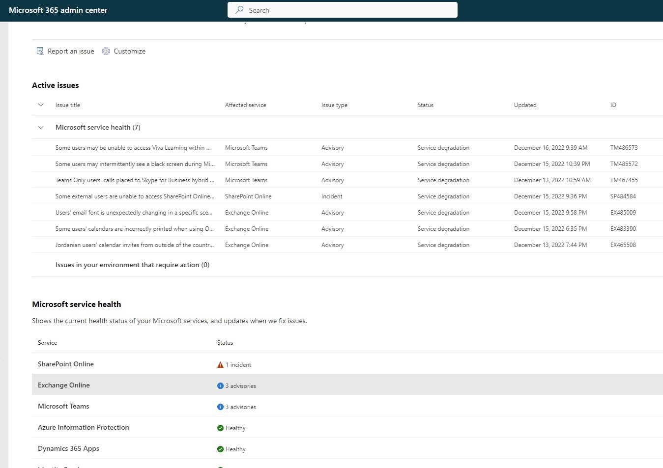

    Thanks for sharing that feedback David. I gave them another prod on my ticket today so we'll see if they give me the same response as and when they reply. I see it still hasn't found it's way onto Service Health and it will make me a lot happier if it does - not least because SAs will actually be able to see it rather than go hunting as you have had to.
