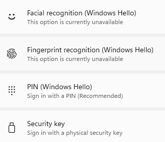

It used to be that when I accessed my Personal Vault, it would ask me to authenticate with Microsoft Authenticator. That suddenly disappeared, and now it gives me the options of authenticating with a fingerprint or my PIN. I don't want my PIN to work to get to my Personal Vault. Other people use my PIN to access my machine. I don't want to use the same authentication to get to my personal vault. I want that to go to Microsoft Authenticator so that it is different.
Why did it change, and how can I change it back?
