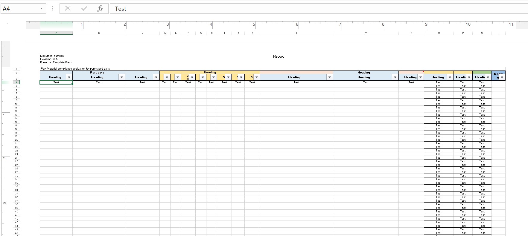

    I have one challenge in the below code if I have one row retuned from the wsSource to wsOutput
    O4, P4 and Q4 populate to the end of the sheet cuz when I recorded the macro to find the last row. I used Ctrl Shift Down. If there is only one value in A4 my macro also starts from A4. So it goes all the way down to last row in the sheet 1048576.
    To overcome it, I adjusted my range to A3:R3 also tried A2:R2. However, in the R column R3 is merged R2&R3 see screenshot so Ctrl Shift Down won't select the A4:R4 row. Therefore, no borders to the last filled row of the sheet.
    Need to fix it with a logic.

    Range("A3").Select
    **Range("A4:R4").Select**
    Range(Selection, Selection.End(xlDown)).Select

    Q5) I might have not explained it clearly with the boarders. When I run the code it removes all the boarders.
    After I run the macro say it had 20 used rows so I would expect all 20 rows to have all boarders (A1:R20). I save the file as .xlsx then I would clear the contents.
    When I run the code with a new number. I might get 400 rows of data or less 100 rows. Now the boarders have to be dynamic for 400 (A1:R400) or 100 (A1:R100).
    If it were 400, boarders until 400th row no boarders thereafter. If it were 100, boarders until 100th row no boarders thereafter.
    I don't have to worry after column R there are no boarders applied as those columns are not part of the used range.

    Q9. However, I face issue with all boarders. The template I use has conditional formatting so if I use Clear instead of Clear.Contents conditional formatting is gone.
    Clear.contents leave the boarders and when I run the macro with a different input number now the boarders are beyond the last row.
    A9. See the code example below where I clear the borders below the data and to right of data without affecting Conditional formatting.
    Also see where I have populated the date cells directly with the value from the VBA Date function and it is not necessary to Copy -> PasteSpecial -> Values.
    See how you go with it and again feel free to get back to me if any more questions or problems.

    With wsOutput
        'Next line: Call the UDF to find the last used row on the worksheet
        lngLastRow = LastRow(.Cells)  '.Cells is entire range of wsOutput.
        .Range(.Cells(4, "O"), .Cells(lngLastRow, "O")) = strCity
        .Range(.Cells(4, "P"), .Cells(lngLastRow, "P")) = Date  'Date is the current date in VBA
        .Range(.Cells(4, "P"), .Cells(lngLastRow, "P")).NumberFormat = "dd-mmm-yyyy"
        .Range(.Cells(4, "Q"), .Cells(lngLastRow, "Q")) = "C"
        ***'Remove all borders below the last row of data***
        strRowRef = lngLastRow + 1 & ":" & .Rows.Count
        .Rows(strRowRef).Borders.LineStyle = xlNone
        ***'Remove all borders from column after last used column to right extremity of worksheet***
        ***'Next line just used the actual column reference from next column***
        ***'past data to maximum columns because usually known range.***
        .Columns("S:XFD").Borders.LineStyle = xlNone
    End With
