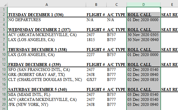

    I don't wanna be rude, but this is really crazy. All the work is like a house of cards, if just one card falls somewhere, everything falls apart and nothing works anymore.
    Have a look at the dates in column A and column D, I've stopped the code before you modify column D.
    IMHO the output is wrong.

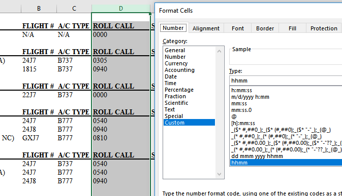

    Anyway, here is just one way to only show the time, without even a line of a macro:
    Before:
    After:
    IMHO you should consider revising the whole project. Start at the origin: where does the data that you process come from?

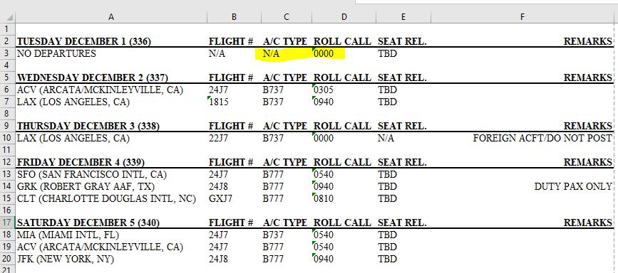

    I got some great news I got it to work (Row 10), but I need just one little thing now in the first macro, I need it to include "N/A" (Column C) along with "ROLL CALL" and with <> 4. In the end I had to add extra macros, but I got the one result I needed. Do you think I can put that second macro in one of the other macros to save one extra macro? Can I add that extra rule for the "N/A" without coming up with a new macro? Thank you so much, you guys definitely motivated me. I'm definitely in better spirits.
    Sub remove_hidden_Times()
    Dim Cell As Range
      For Each Cell In Sheets("72 HR").Range("D2", Range("D" & Rows.Count).End(xlUp))
        If Cell.Value <> "ROLL CALL" And Len(Cell) <> 4 Then
            Cell.Clear
             End If
      Next Cell
    End Sub
    Sub Roll_Calltext()
    Columns("D:D").NumberFormat = "@"
    End Sub
    Sub Inert_Midnight()
        With Sheets("72 HR")
              With .Range("C2", .Range("C" & Rows.Count).End(xlUp))
                      .Value = .Value
             .SpecialCells(xlConstants).Offset(, 1).SpecialCells(xlBlanks).Value = "0000"
          End With
       End With
    End Sub
