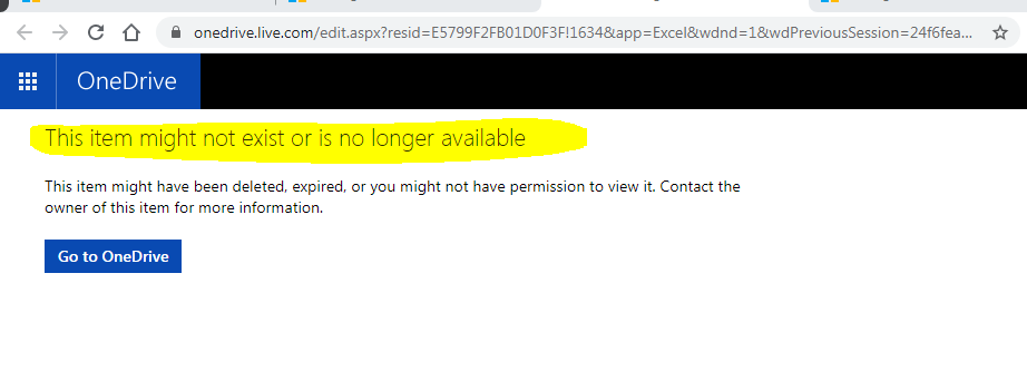

    2020-11-30T10:03:08+00:00
    It is not possible,
    This is what we get
    Due to the size your workbook might have, I suggest you
    1-To ZIP your file
    2- Then Upload it to one drive
    3- Later share the link to that ZIPped folder
    Regards
  2. Andreas Killer 144.1K Reputation points Volunteer Moderator
    2020-11-30T10:00:34+00:00
    I did post a link which I hope can be accessed.
    The last link you posted on 11/30/2020 10:39:45 AM is not valid:
    Please check the videos provided by Jeovany, choose the Online File Hoster of your choice and try again.
    This article might be helpful also:
    Share OneDrive files and folders - Office Support
    Andreas.
