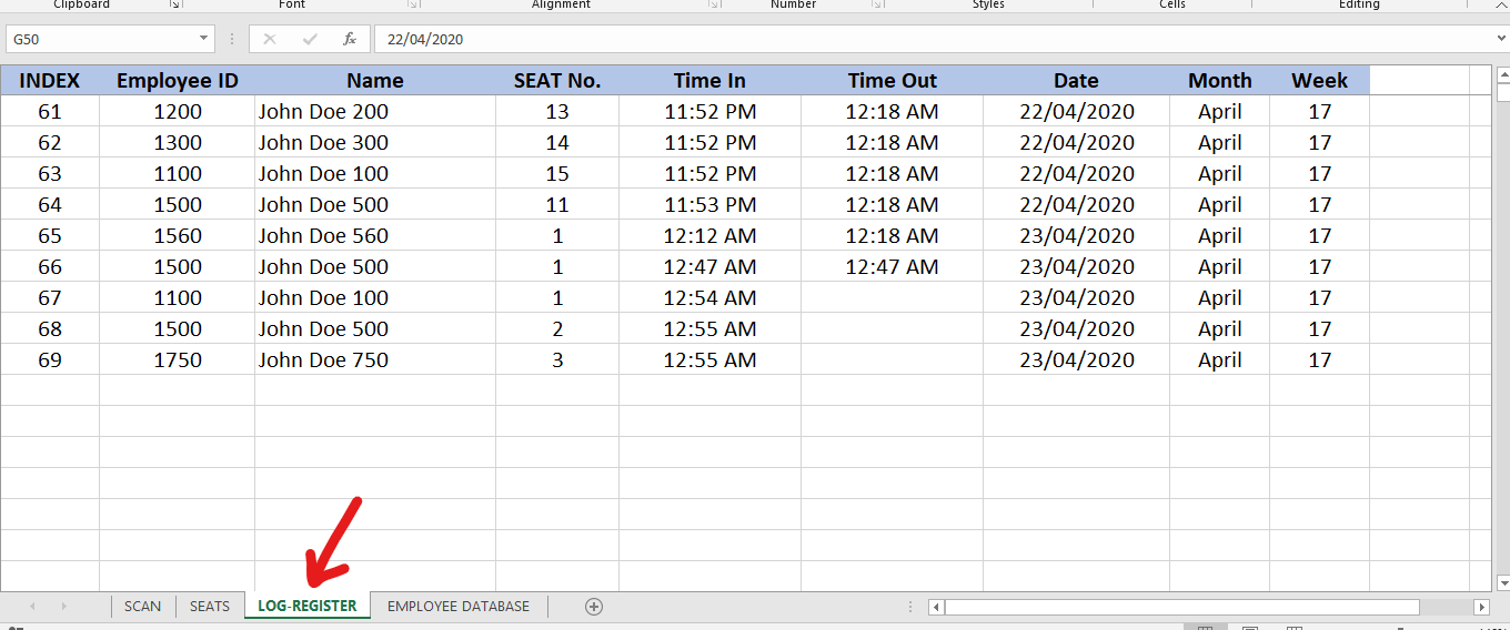

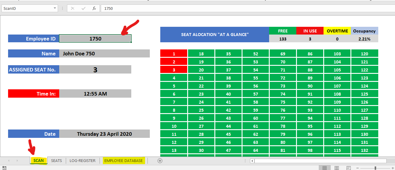

1- Before the start
The SCAN sheet will look like this, The scanner will be focused on cell C3 Named range ScanID

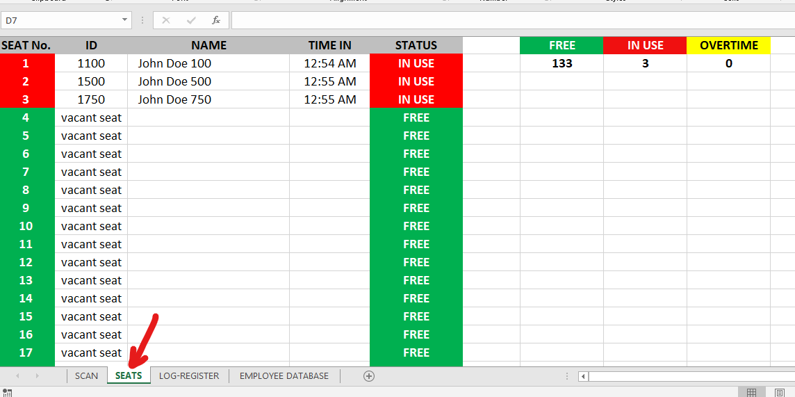

2- After the first 10 scan (employees)
After the first 10 scan (employees) on each sheet
RECORD/TRACKING before any check-out.
3- After some of the staff check out
Conditional Formatting is applied to cells
the ones in Yellow shows those who are taking more than 30 min in their lunchtime and obviously haven't been checked out.

    2020-04-23T04:13:21+00:00
    Hi Rohn
    On my file all is automated
    If you pass (type) twice the same ID number in the only unlocked cell on SCAN sheet it will record the check in and check out.
    I just didn't have the time to explain it.

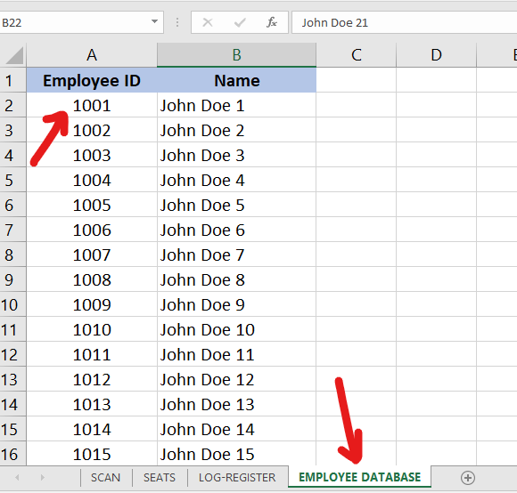

    2020-04-23T00:09:59+00:00
    Hi Debbie
    Please, download from the link below a file created to find a solution to your problem.
    https://1drv.ms/x/s!AjGRD1TlwpAGlniwIxOU1dlDFhbK?e=FQd9Wa
    Some pictures
    Play around with the file.
    Manually type the IDs numbers from 1001 to 1800 and see how it works
    Then replace the employees database with the real one (just ID numbers and Names)
    Sheets are protected with the same password you gave us:= "wet"
    Do let me know how it goes.
