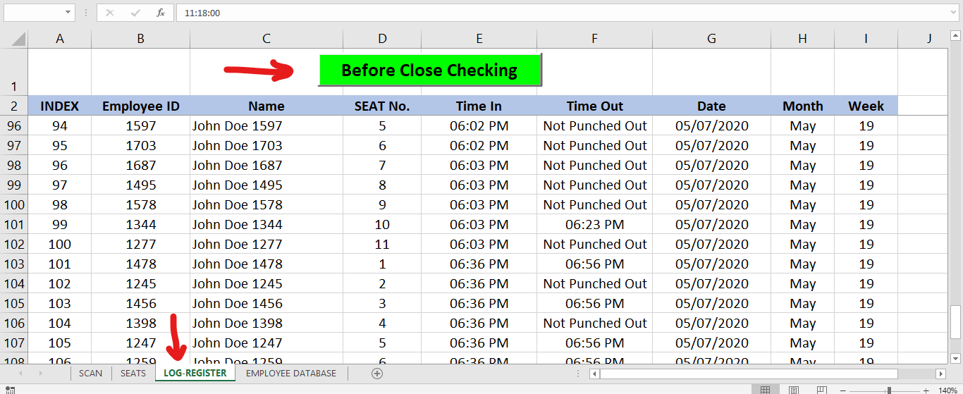

    Since we have the files on SharePoint,we are struggling with an error that says it could not merge changes and save, so it closes and reopens the file. Does that mean that if this happens, the macro will mark as "not punched out" all of those that were blank at the moment of the error?
    Unfortunately, I can not give you an expert opinion regarding SharePoint issues.
    Anyways, I removed the macro from the workbook event and created a Command Button you would now have to click before closing the workbook to mark as "not punched out" all of those that were blank at the end of your working day.
    Here the link with the updates
    https://1drv.ms/x/s!AjGRD1TlwpAGlniwIxOU1dlDFhbK?e=uneb2E
