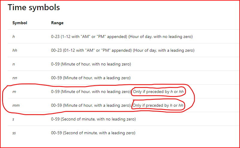

    I did misunderstand your comment. I thought you were indicating that I had use n in lieu of m.
    I question your comment: youmustuse n for minutes, m is always for month in VBA.Format:
    My interpretation of the info in the link you provided is that m can be used when preceded with h so when used in combination with hours it is valid. It all works for me that way.

    I can't find anywhere that I used n for minutes. Where in my code do you believe you found it? Have I overlooked a typo somewhere and can't find it?
    Hi Ossie,
    you must use n for minutes, m is always for month in VBA.Format:

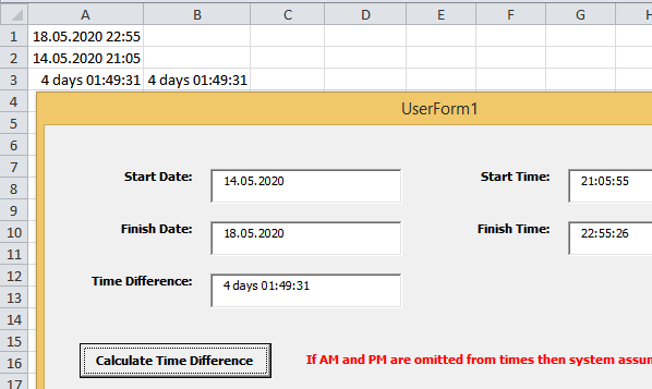

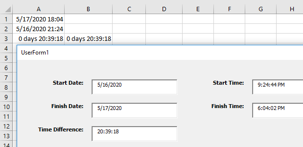

    The next step to support the local date format at the users end is to use VBA.FormatDateTime instead of VBA.Format to fill the Textboxes. After that it works where ever you are.
    Copy the code below into your sample Userform, run it and click the button.
    Here is a screenshot from my German PC:
    Here is one from an US virtual machine:
    As you see it doesn't matter which local format the end user has.
    Andreas.
