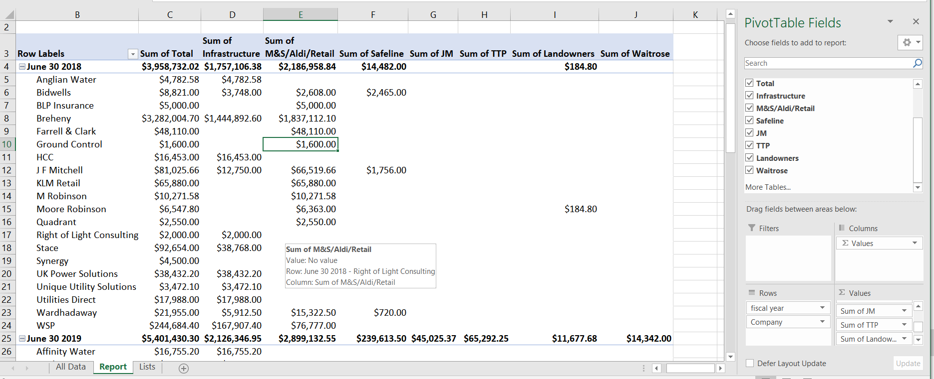

    2019-08-26T21:45:16+00:00
    I've created a PivotTable version that may work for you. See my comments on how to use it farther down:
    https://1drv.ms/x/s!Am8lVyUzjKfpoCWxBLSbfkUro9sL?e=SJFD7Q
    What is the "No." in the first column?  What is the point of the line numbers in column A?
    Why do you have a whole bunch "9.0 Year End to June 30 2018" headings?  Same with 10.0's ...?
    Your "All Data" tab is setup more like a final report.  If you make the input table just that, input only, then you can add validations and rules. Then worry about splitting out the year end reports and totals.
    The "total" column should be just that, a calculated total, summing the other columns.
    Jeovany's example points out one problem with your current input sheet, that has been already mentioned. The problem of no input validation, so you have both "40 Cent" and "Fourty Cent" as variations on the same company name.  His macro has created 2 separate tabs for the 2 names, not what you want.  I've confirmed that in my version of the workbook the second "Farell & Clark" entry has a trailing space, bad data entry which is corrected using excel validation

    I've created an example with following features:
    • Input data is now an Excel Table
    • Company is now a drop down input, from a filtered list
    • Totals column moved to end, calculated as sum, not data entry
    • I've added a new "fiscal year end" column
    • I've added Slicers for fiscal year and company name
    • I've cut the input data down to just 2 fiscal years to play with
    • I've sorted the input table, but you can resort it yourself on any column(s) you need
    • I've highlighted the totals column as a clue that it is not data entry.  Actually, you should consider removing it from data entry, it can be added back in pivot.
    From the input data I've created a Pivot Table with following features:
    • Slicers for Fiscal Year and Company
    • after making "All Data" tab changes, ie new rows, changed data in an existing row, just right click on Pivot table and select "Refresh" to import the new data and recalculate
    When doing data entry, you can use slicer to limit display to fiscal year and company. Just enter the data in the row at the bottom of the displayed.
    Here is the overal pivot table:

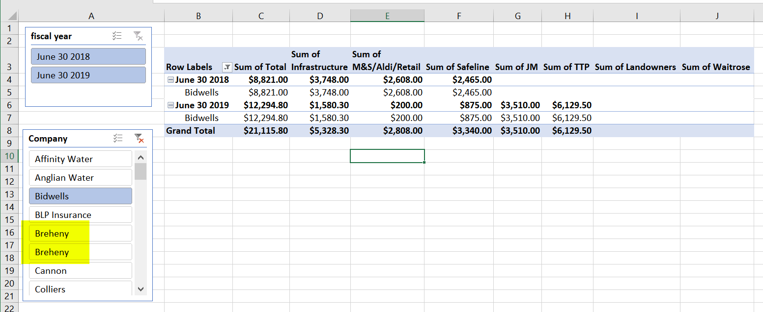

    Here is 2 year pivot summary for 1 company
    Note the company name that is showing duplicate entries. Probably due to bad entry of company name, with extra spaces.

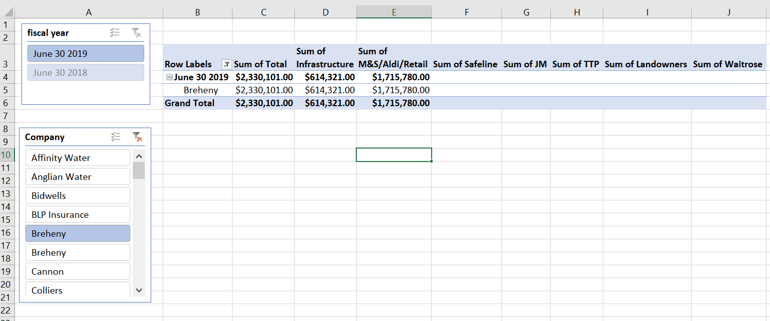

    Here is results for first Brehany entry:

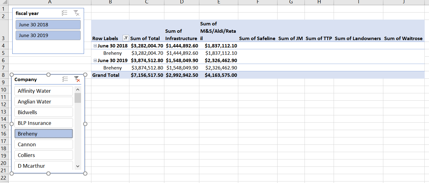

    Here is result for second entry:

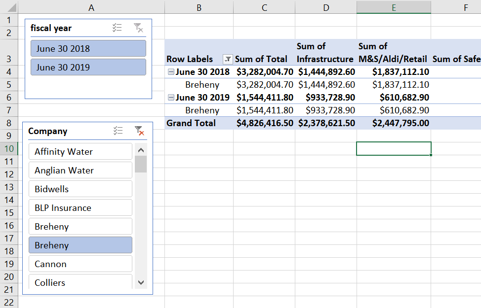

    Here is report after I copied a single entry of the "Breheny" text into all of the columns
    this new single entry reflects the correct total.  I haven't checked Jeovany's example, but I bet it has 2 separate tabs.
