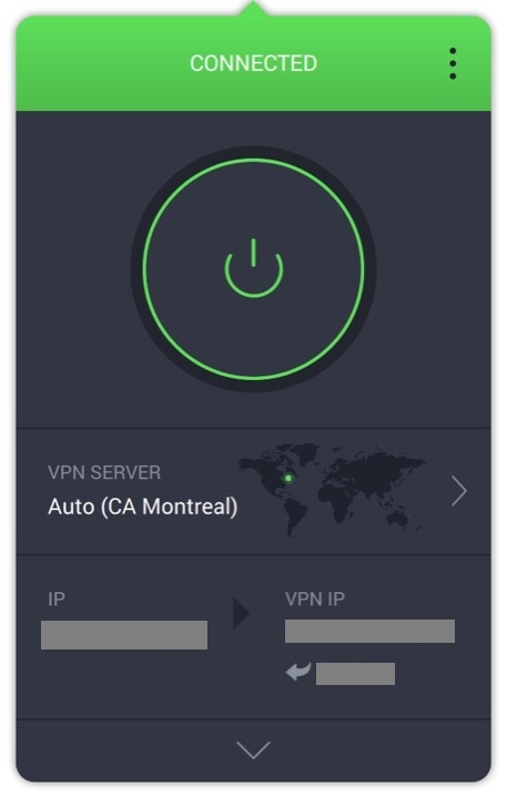

    I went back and reconnected my VPN - this bypasses my ISP - COX CABLE - and puts me on a server in this case in Montreal. My laptop is setup for DNS 8.8.8.8 and 8.8.4.4.
    MAU ran the same with the same symptoms as prior. I don't have cell service where I am so I'm trying to find another way to get a different network. Yesterday I took my laptop to a car wash and used their WIFI same issue but I can't be certain about their DNS service - it might be the same issue.
    I can download from that URL via the VPN as well but it works the same either way - the package downloads.
