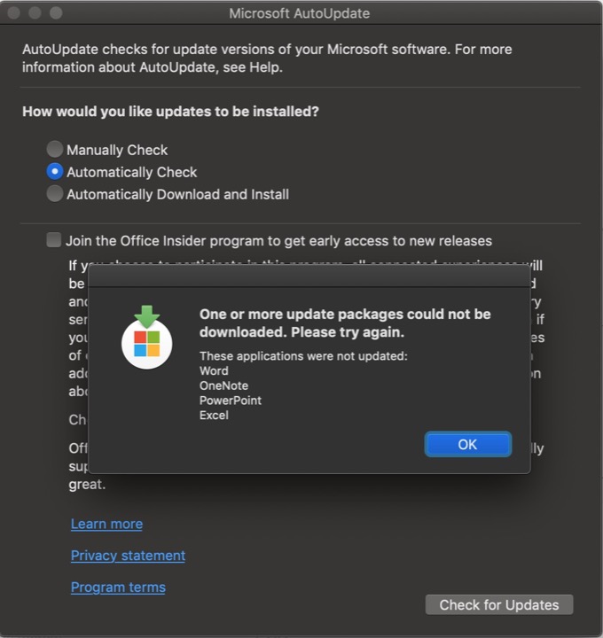

Microsoft Auto Update gives "One or more updates package could not be downloaded" message
2019-07-02T07:24:01+00:00
This is for MacOS 10.14.5
Microsoft AutoUpdate is v 4.12
Office Updates are 16.26
Worked with first level support to completely clean my Mac of all microsoft products and reinstall latest package.
Ran in SAFE MODE no change.
Ran Cocktail and Disk Utility no change.
Repaired permissions no change.
I post this issue (which I believe is only showing up on my Mac - others in our house don't do this - every time an update occurs. First MAU comes up with an update to itself which doesn't download, then I take a new copy of MAU off the MS website and install it manually, then it works and shows the new updates which then won't download - same issue, so I then download the whole MS office and install it, then everything works again until the next autoupdate which then has the same issues.
Watching the progress bars it appears that the files just don't want to download and save in whatever spot it's trying to put them.
Just to clarify - I have MAU 4.12 now, and I have Office 12.26 installed. Everything is the latest. But MAU runs and says a new MAU needs to be installed and that is 4.12.0 and when it tries to download is when this happens.

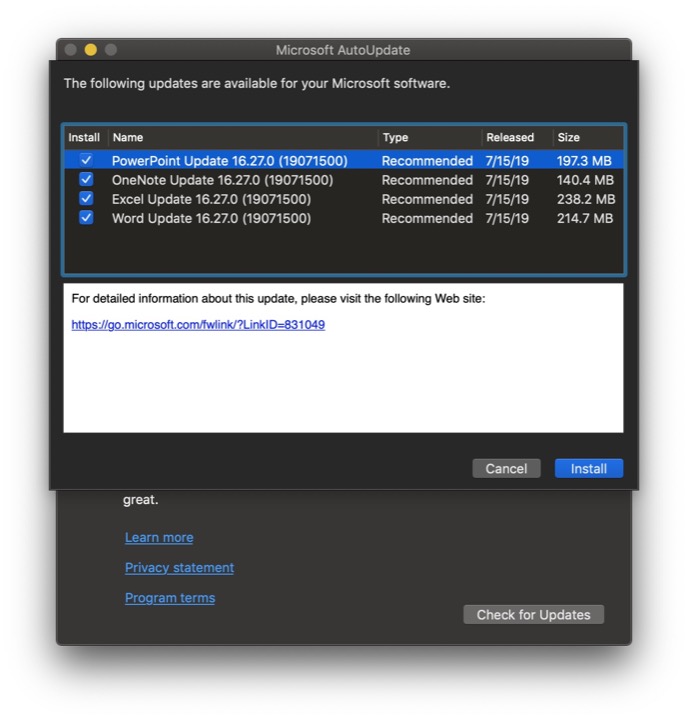

    MAU 4.12 wants to download 16.27.0 updates for office applications and when I try to update the updates result in failed downloads.
    So this is the same exact issue that we cured last time by doing a manual download off the MS website. The whole autoupdate cycle just doesn't work on my computer.

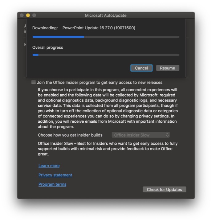

    As I observe the update, everything goes as expected but if I observe carefully as the progress bar shows the download of each of the application packages...
    I note that the "overall progress" resets to zero after each download. This indicates that the download of each successive package is not successful. This gives a very strong indication that the problem is specific to the download success and is most likely the permissions for the folder that is created or used for downloading.
    I have seen reports on this forum that note the person found the root folder per in 'private/var...' and was able to move the files to their desktop and create an update using some complex commands from their "terminal" application on the Mac that I don't really understand. This would indicate that a similar problem was not similar at all because the packages actually downloaded. I do not believe that my packages are completing their download.
