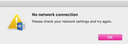

    And also thanks for you support of the Microsoft. Sorry for the inconvenience the issue causes. We are aware of the issue now. As a workaround several community members mentioned that Installing 15.41 can get rid of this issue. Affected users can choose to install this previous version or use Office Online temporarily before the final fix released. We will keep working on the issue.

    The possible scenarios:
    1.    You may get error message that “no network connection. Please check your network settings and try again”.
    2.    You may see a spinner forever saying “loading” when you try to sign in.
