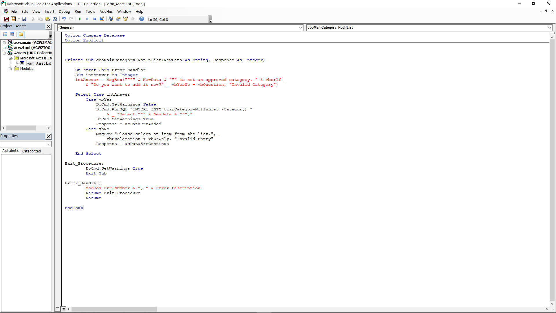

    Hi DennisWelch.
    The code you are showing is for the main category combo not in list.
    You need to highlight the location combo as you have done,  then on the property sheet go to the not in list event, click on the ellipses to open vba editor which will add 'private sub cboLocation_notInList etc etc.
    You then add the code as you have for the category not in list. You will have to make some changes to the code though to insert into the correct table i.e. location table.

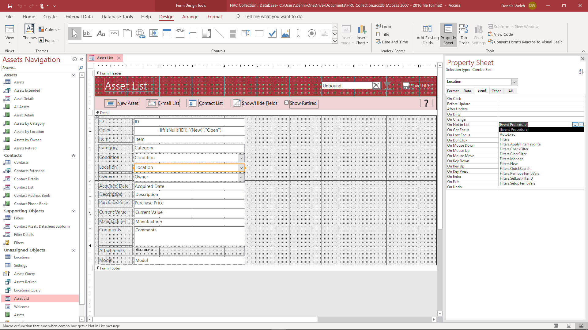

    It seems my code is not being run. I guess I don't know how to save my procedure and assign it to the combobox on my form.
    Here is what my design mode of the form looks like. If I click on the ... elipsis it opens VBA and shows me the code I posted in the last message, but how do I save this code? Clicking "Save" from the file menu saves my database, not the procedure.

    Can you show us the code you put in the NotInList event for the location combo/
    Here is what I currently have: (I wish I would get email notifications that you responded! I've selected the box to notify me when someone responds and verified my email address is correct))
