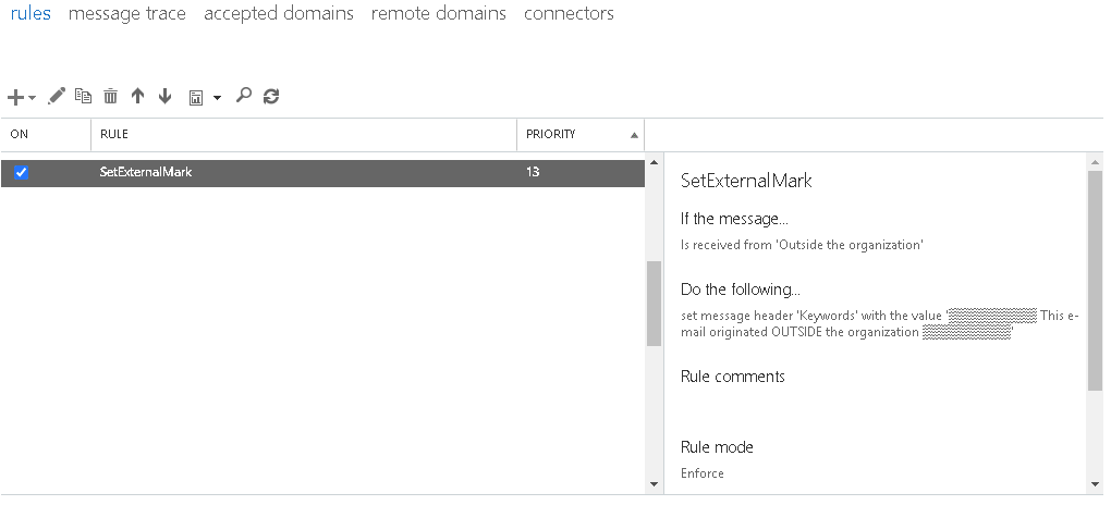

    You can add a category to the message instead of changing its subject line or prepending the body text.
    Try this rule:
    I like this idea, but it doesn't seem to display the disclaimer anywhere in Outlook on desktop or mobile. Where does it show up?
