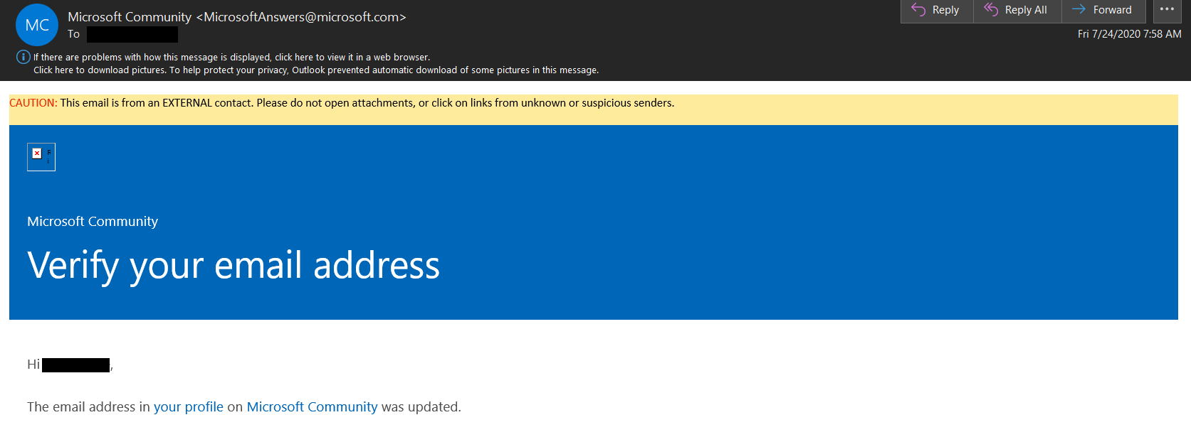

    2020-03-12T23:08:29+00:00
    Hi there - thanks for the code - it worked a treat.
    On regular emails the new disclaimer message appears just as intended.  It also appears in the inbox email list in the preview, also as intended.
    But interestingly, on some marketing emails the disclaimer is hidden in the preview and when the email is opened.  But if you choose the "View in browser" option then the disclaimer appears.  The image here shows what one email looks like viewed normally (no disclaimer can be seen) and below that is the "View in browser" option, where the disclaimer appears. Any thoughts on why this may be happening?
