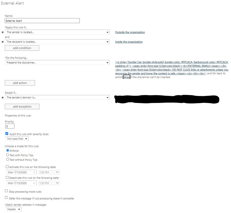

    To me it looks like you may have two Mail Flow rules, or one rule with two actions.
       One that is Prepending the disclaimer (Yellow one that starts with "Caution")
       And one that is Appending the disclaimer (Red one that starts with "[External")
    I can't seem to remove the image that comes at the bottom! Can you help?
    I have used the exact HTMP that you have provided in the article.
