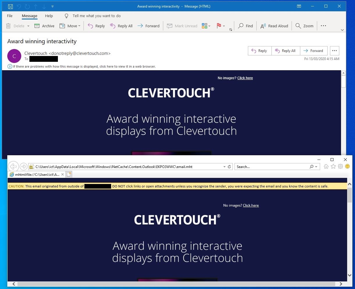

    Does anyone know if there is a way to avoid this taking over the Preview window in Outlook?  See below, I have a snippet of a preview in my inbox, Is there a way to have this preview pull the text after this Prepended disclaimer?

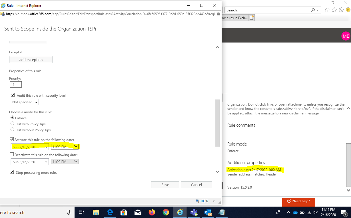

    Jim,
    It looks like MS removed your e-mail address.
    Here is our full rule in O365 Exchange.
         The blacked out "Except if" are domains that we trust, i.e. partner companies, certain vendors, etc.
    We have this rule set as first priority or "Priority 0", so it fires off before any other rules we have.
    When testing, I set the recipient for only myself and a couple others I could use as testers. I then sent e-mails from external/personal e-mail accounts, and also received actual external emails.
    Hopefully, this helps.
