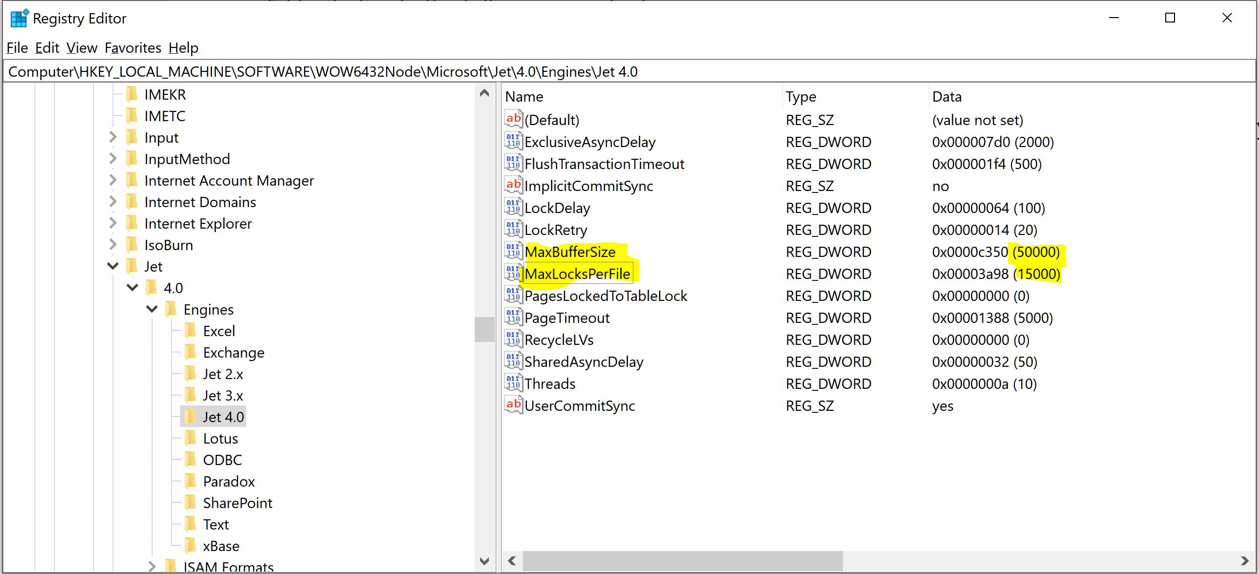

    Step 4: In the right pane of Registry Editor, double click MaxBufferSize. On the Edit DWORD Value dialog box, click Decimal. Modify the value of the Value data box as required, and then click OK.  I have changed it to 50000. Do the same for MaxLocksPerFileto the value of **15000.**Also change Threads to the value (demical always) to **10.**So the demical values have to be:
    MaxBufferSize = 50000
    MaxLocksPerFile = 15000
    Threads = 10
    <REBOOT THE CLIENT MACHINE>
    Have a look at my Registry Setup:
