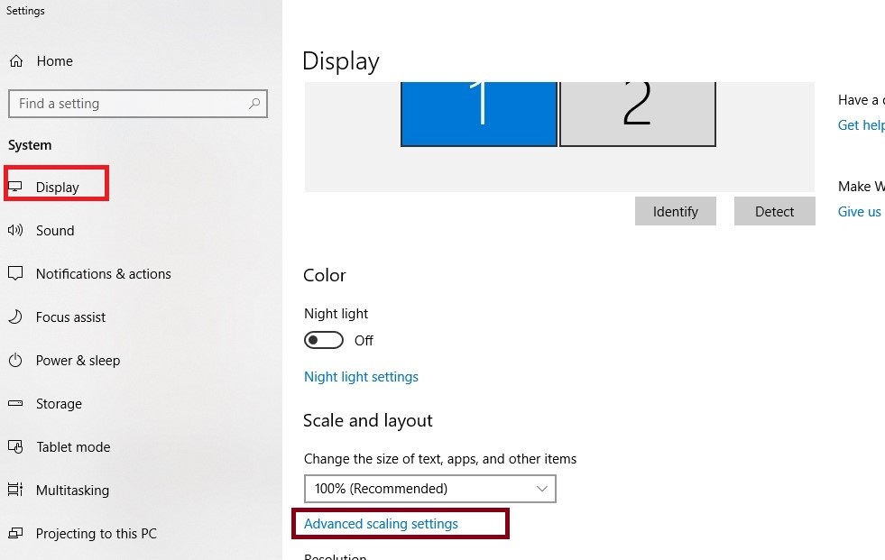

    There’s another thing about display settings we can try. Please also go to Windows Settings > System > Display > Advanced scaling settings > turn on “let windows try to fix apps so they’re not blurry” option to see if there’s any difference.
