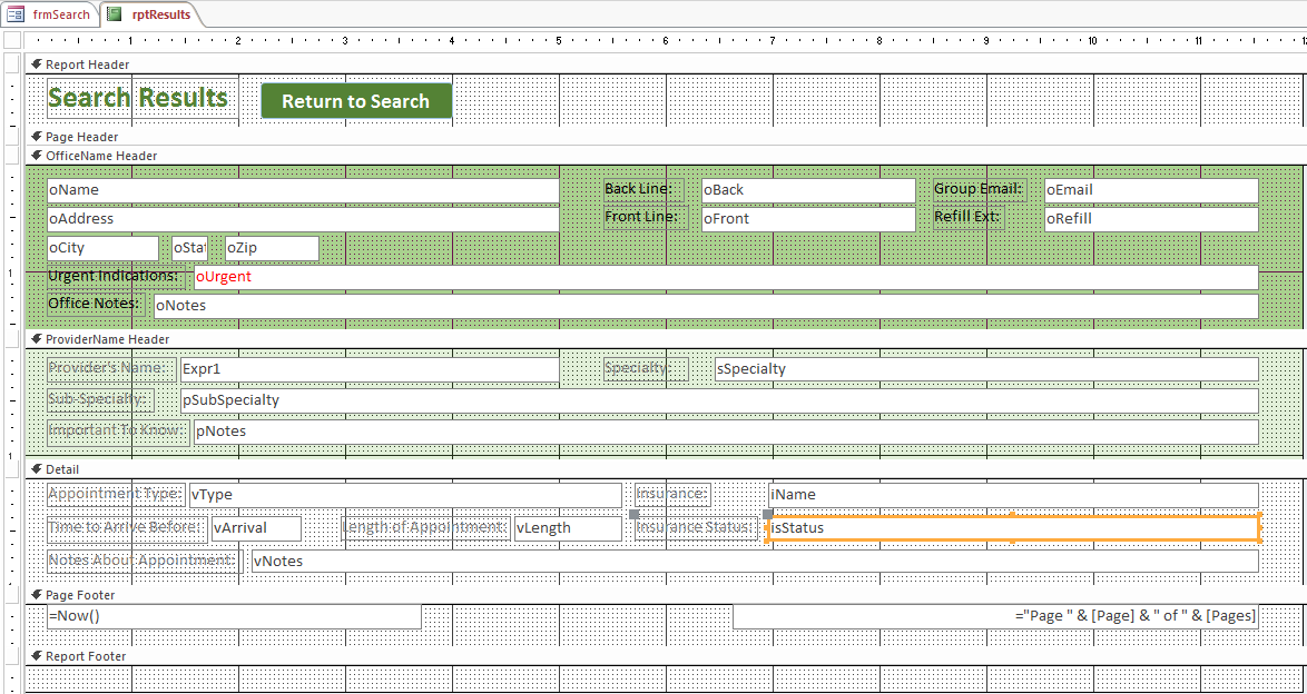

    The only change I made was to add the Insurance Status back in. It somehow disappeared over the weekend.
    So I will try to figure out where that needs to be added back into the code. Since the Insurance Status is populating in the "report" above ("Contracted"), I assumed all was well.

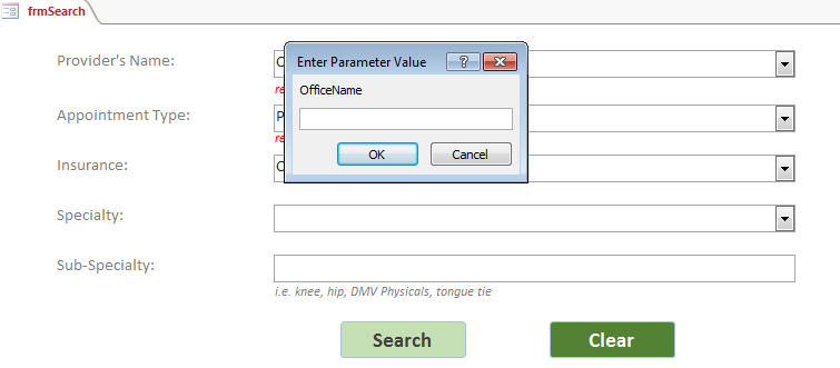

    Hmm, did you change the name of something in the Record Source and did not update the code?  Or visa versa?  That would be the only reason for the boxes.
    You will need to add the last two combo boxes to the code behind the Search button.

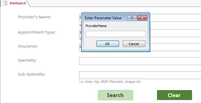

    I have studied my errors and learned a few things. I didn't realize I wasn't supposed to use the [ ] sometimes.
    Now two boxes are coming up after I hit the Search Button. I will try to figure that out.
    Thank you for helping with the macro for the Search Button. I see that there is a acViewPreview for reports. We don't want to encourage printing so I was trying to turn off the acViewPreview by using something else in it's place. So I've replaced acViewPreview with acViewReport.
    Now I will try to figure out how to search "Specialty" alone without any data in the top three (Provider, Appointment, Insurance). I also want "sub-specialty" to be searchable by a term the end user types in, such as Knee, or Hip or Ankle.
