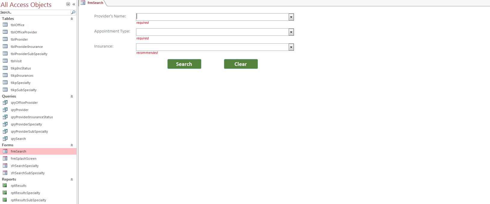

My boss asked me to do a new Access database from scratch. I’ve never done an Access database on my own before, and would appreciate any advice you guys have. This is to help employees schedule appointments for 46 medical doctors in 14 different medical offices.
As for my relationships, I hope I’ve set up everything correctly:
As you can see, I’ve set up two junction tables, but am not quite sure how to set up a search query with junction tables. I’ve looked in my two Access 2013 books, and I’ve also looked online but am not having much luck. For example, with the table Junction_Provider_Insurance, I’m not sure how to search the Junction table to pull up the doctor and if the doctor is contracted, not contracted, needs authorization or pending for the insurance. So if a doctor’s name and an insurance name such as Aetna is searched, I want the result to show that the doctor is or is not contracted with Aetna in ReportResults.
As for the search, I originally set up a wildcard search for all the search boxes. My original intention was that the user could type in anything they wanted in one or two or three of the boxes (such as doctor’s name, visit type and insurance) and do a search where the results come up. However this is not working at all and time is of the essence as I’ve already missed my deadline to turn in this a week ago.
Due to missing the deadline, I decided to change the wildcard text search to a combo box for the Doctor’s Name, Medical Office Name, Visit Type, Specialty and Insurance in the hopes the search will finally work. I’m thinking the best way to handle this is to remove the medical office, and then just have the doctor’s name, then when that comes up, to cascade into a new combo box for the visit type (new patient, follow up, pre-op, post-op, etc.) Or is there a better way to do this? I still need the results to show in the report too.

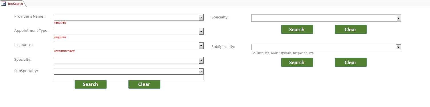

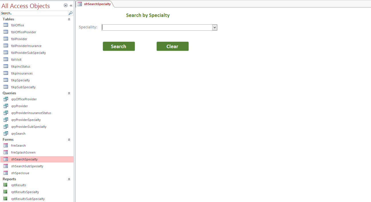

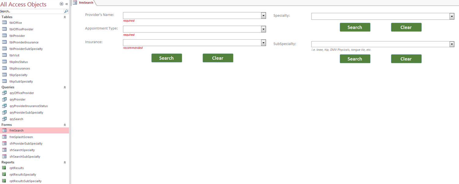

    I ended up bringing in two subforms as the search still is not working. I was also afraid people may be confused with everything the way it used to be - with only one search button. The two sub-forms are called sfrSearchSpecialty and sfrSearchSubSpecialty to the right of the screen. So now I have:

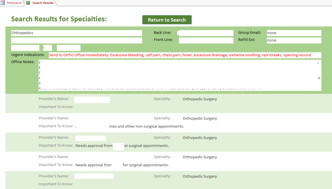

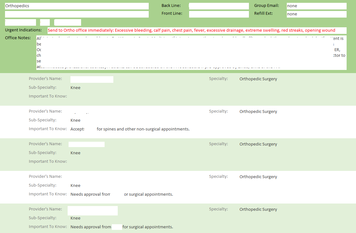

    If I do search on the subform Speciality for "Orthopedic Surgery" it comes up, and gives us all the Ortho Surgeons so that's great:

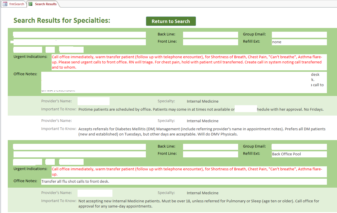

    If I do a search on the subform Specialty for Internal Medicine, it gives me three IM providers in two different offices, so I am happy with that, as it is working somewhat. It's not picking up all IM providers in all offices though. The first office actually has five providers, and the second office has two providers.
    If I do search on the subform SubSpeciality for "Knee" it comes up, and gives us all the Ortho Surgeons that work on knees, so that's great. Unfortunately it doesn't work on the other subspecialities and I'm not sure why.

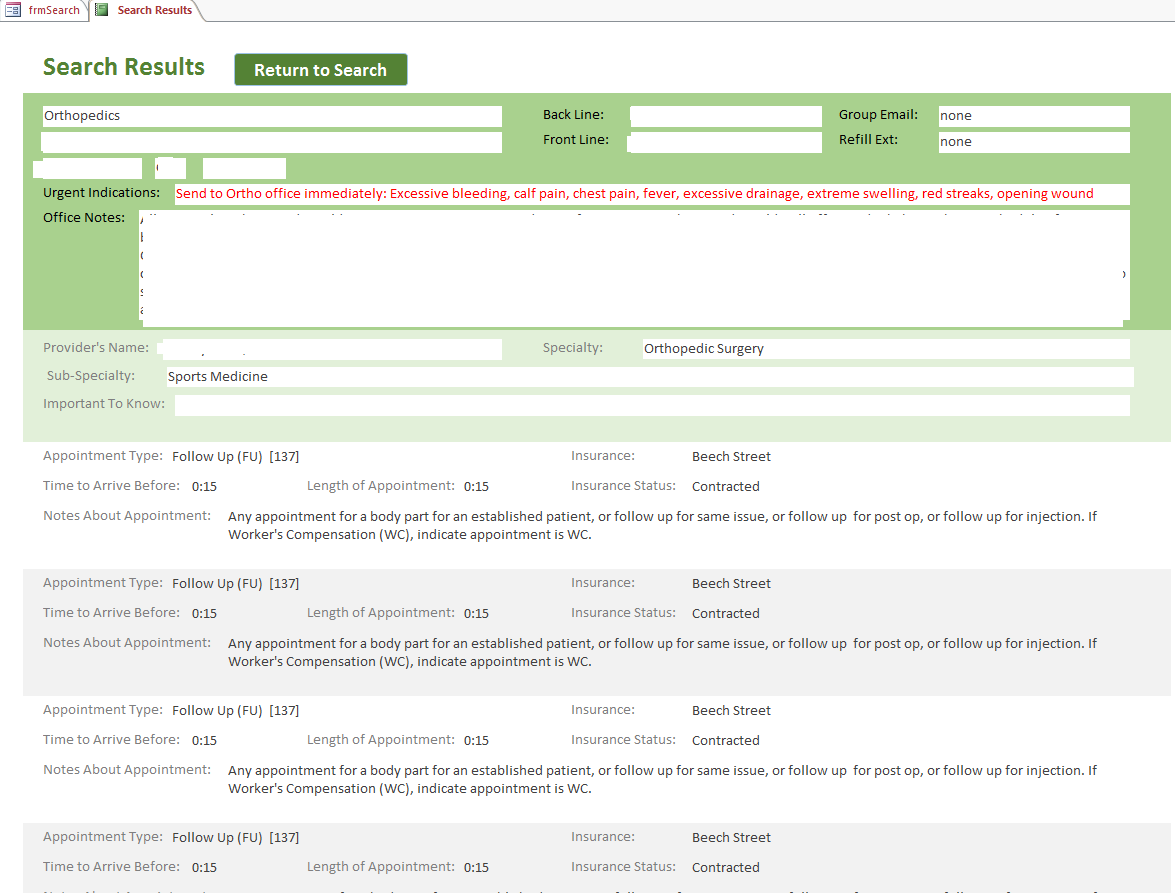

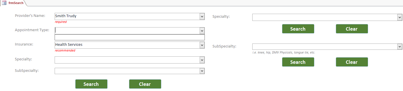

    Unfortunately the main search, with Provider + Visit + Insurance is returning a ton of duplicates, repeating the one item over and over.
    I will be working on this all weekend, trying to fix the main search so it does not repeat 50 times, and also trying to fix the other searches.  Thank you so much for your time and help.
    Main Search:

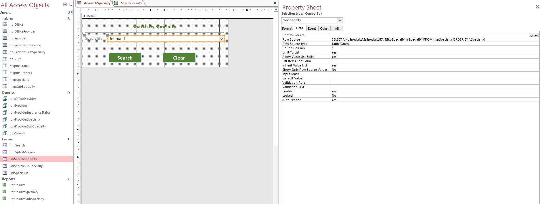

    Specialty Search:
    Option Compare Database
    Option Explicit
    Private Sub BtnResetSpecialty_Click()
     Dim ctl As Control
        For Each ctl In Me.Section("Detail").Controls
            Select Case ctl.ControlType
            Case acTextBox, acComboBox
                ctl.Value = Null
            Case acCheckBox
                ctl.Value = False
            End Select
        Next
    End Sub
    Private Sub BtnSearchSpecialty_Click()
    On Error Resume Next
            Dim strWhere As String
            Dim strSQL As String
            Dim lngLen As Long
        'Number field example. Do not add the extra quotes.
        If Not IsNull(Me.cboSpecialty) Then
            strWhere = strWhere & "([sSpecialtyID] = " & Me.cboSpecialty & ") AND "
        End If
        lngLen = Len(strWhere) - 5
            If lngLen <= 0 Then
                strSQL = strSQL
                DoCmd.OpenReport "rptResultsSpecialty", acViewReport
                DoCmd.Maximize
            Else
                strWhere = Left$(strWhere, lngLen)
                strSQL = strSQL & " WHERE " & strWhere
                DoCmd.OpenReport "rptResultsSpecialty", acViewReport, , strWhere
                DoCmd.Maximize
                Reports![rptResultsSpecialty].Filter = strWhere
                Reports![rptResultsSpecialty].FilterOn = True
            End If
    End Sub
