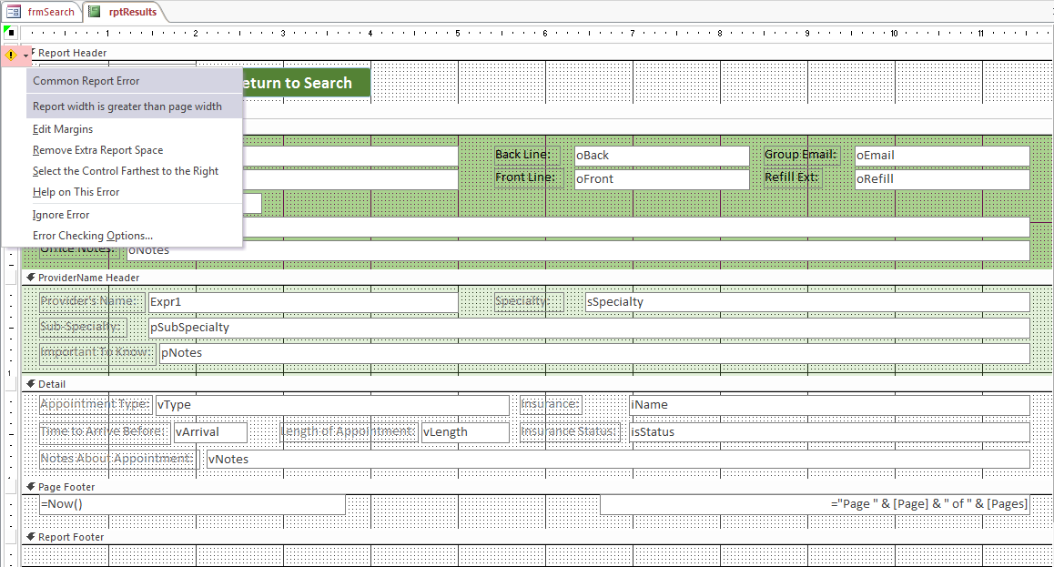

    Well that one about the Report Width has to do with Paper Size (and margins)
    I see the other two they are the result of your Groupings
    OfficeName Header needs to be oName
    ProviderName Header needs to be Expr1

    I had corrected the insurance status yesterday by using the little triangle to figure it out - very handy to have. I've opened the report in Design mode, and there doesn't seem to be any errors other than the page width.

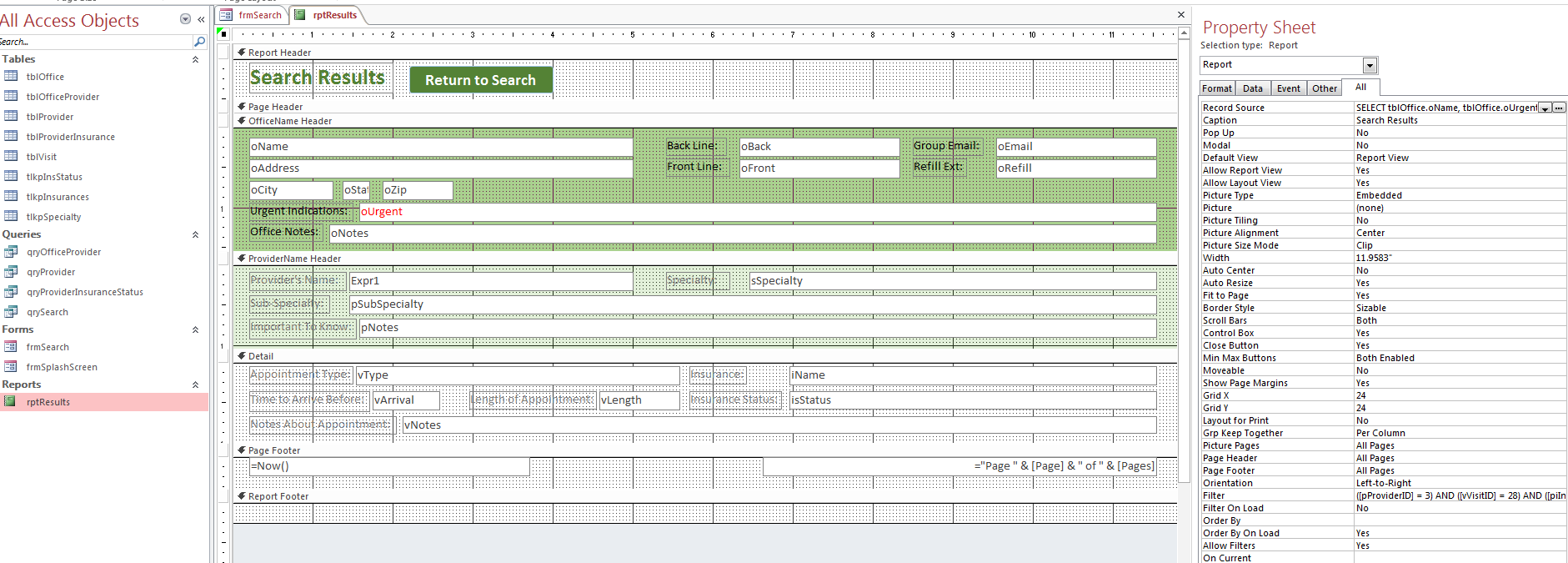

    To do additional checks to the Report...  Open the report in Design Mode and look for some little triangles, they will point to what controls on the Report do not match the Recordsource.
    2018-10-30T20:45:44+00:00
    Hi Gina,
    Thank you for your suggestions. I opened the report right from the Navigation Pane and the pop ups still occurred. I have tried everything to remove the two pop ups. I guess I have to delete that report and do a new one from scratch as I have spent over eight hours trying to fix the pop ups.
