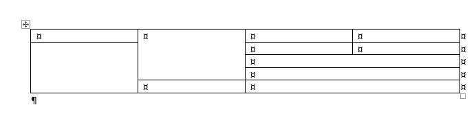

    Secondly, I noticed the issue occurs (at least on my machine) when I merge cells vertically below the first (top-most) row. If I merge horizontally, I can still type. And if I merge vertically and include the top-most row I can still type.
    I tried to trick the system by merging cells vertically with the top most row to get the cell merger I needed and then adding a new row above for my header information. The system somehow reverted back to bug and made my text invisible. I suspect the text is actually there but it is hidden above the upper bounds of what is being displayed.
    I have included a screen grab to  illustrate what I have found out. As can be seen, the left most cell merger is not capable of being typed in (no end of cell marker). The other mergers you can still type in, as indicated by the end of cell marker still visible.
