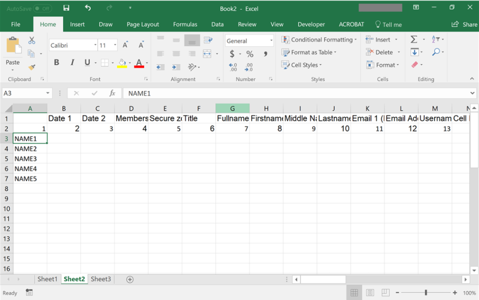

    and that blank worksheet with the names in it we will be formatting into something that looks like this:

    2017-10-22T03:30:16+00:00
    Also, I forgot to add that if it's easier to do the vLookup, I can move the fullname from column F to column A in the worksheets called Home, Billing, Work, and PO Box.
    2017-10-22T03:08:53+00:00
    In my second post I showed all the names of the columns from A to AQ. As you can see from that list, the fullname is in Column F.
    The worksheets called Home, Billing, Work, and PO Box contain all those columns from A to AQ and the fullname is in Column F. This is because after I had filtered the columns I just copied and pasted them into the new worksheets.
    The other worksheet called "names only" has the list of names in column A - there's nothing else in that worksheet except the names which have been normalised.
    So to summarise, the fullnames are in column F in worksheets Home, Billing, Work, and PO Box and in column A in the worksheet "names only".
    Can you help further to get the vlookup working?
