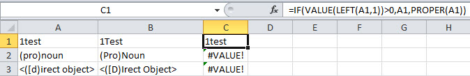

    I do not know if it is possible to do what you want using merely functions in Excel.  The data in Column B of the following screen shot shows the result of using the =Proper() function to convert the data in Column A.
    While with the formula in Cell C1, you can get the desired result for cell A1, that formula does not work for the entry in A2, A3
    I suppose in theory, it may be possible to come up with a formula that does cover all cases, it is going to get fairly complicated.
